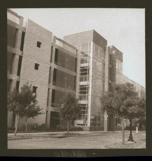

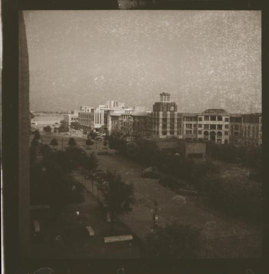

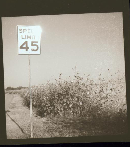

My first impression when I saw them on the first roll was that they were round to irregularly-shaped round "brownish" (dark) spots on the negative that could be seen distributed in various concentrations covering the entire exposed frame. Obviously, they are harder to see in the thicker portions of the negative. I returned that original roll to the fixer for another round followed by another wash that night thinking I may have had an out-of-date or exhausted fixer, but there was no change. I can almost hear the voice of a late engineer friend of mine admonishing me with something along the lines of "you don't know what it isn't, until you know what it is."
I only have a few quickly and poorly scanned examples that I did months ago from the first roll as a test. I don't have access to a film scanner at the present time to scan the second roll as a comparison.

Looks like poor storage/outdated film that has interacted with the backing paper to me. I've had expired Ilford PanF do the same sort of mottling.

I've had this exact problem. I've probably shot and developed 20 rolls of rera pan, and about 5 or so have turned out like this. I do believe it is mottling from the paper backing -- I've even gotten frame numbers, in addition to the strange mottling. Definitely not a developing issue, I've developed 4 rolls at a time in a large tank and had some come out with it, some without. I may soon switch to cutting down 120!
