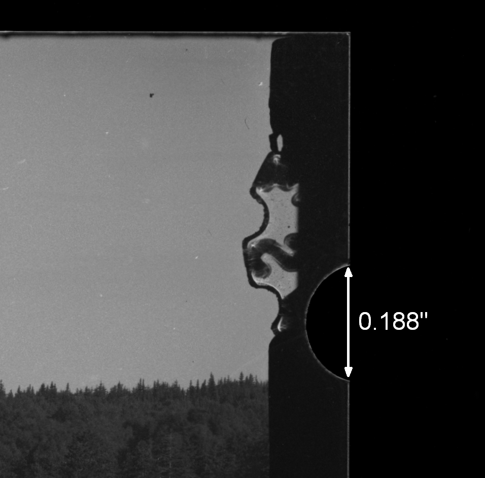

Thanks for all these responses. I will try some different formulations for the remainder of my 400. I am posting a scan of the "notch". This is identical on the both the 100 and the 400. Does anyone have either 100 or 400 Arista Edu Ultra with a different "notch"?

I haven't measured, but by touch, 100 and 320 Foma and 100 and 200 Arista have the same notch. Never shot the other speeds to say for certain, but as far as I expect they are all the same.

I've used .EDU 100 and 400 in 4x5 as well as 9x12 cm -- notch codes are the same for all, AFAIK. BTW, Freestyle offers the 100 in a number of obsolete sizes -- 2x3, 3x4, half plate, etc. as well as some European sizes like 6.5x9 and 9x12.
