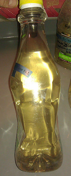

I mixed up a fresh batch of Dektol stock solution (3.8L=1 gallon) and filled up two x 2.0 Litre PET bottles. I squeezed them before tightening the lids to expel the remaining 100mL of air in each one.
One bottle kept its compressed shape but the other slowly expanded again as air leaked in through the less than perfectly sealed lid. I tried tightening the lid and using other lids to no avail. Then I decided to use some teflon (plumbing) tape to seal the thread. Et Voila ! No more air leaking into the bottle !
I know you're probably thinking, why not just get smaller bottles, or even use an inert gas to fill the space above the developer? Well as Dean Hutton from the curiosity show used to quip, "I'm glad you asked". The reason I prefer this teflon tape idea now is that:
1. Eventually when I use the stock and do need to fill up the bottle with an inert gas (my preference over marbles and accordion bottles for example), I can know for certain that the gas will exchange at a much slower rate. This method tests the (very tight) seal using a constant negative pressure.
2. I'm not a fan of accordion bottles or more than two different sized bottles
Unless you have a very tight seal then surely using an inert gas will give you a false sense of longevity. Here are two photos. One showing the teflon tape being applied prior to screwing the lid down tight, the other showing the PET bottle slightly squashed by 100mL. When wrapping the tape, ensure some overlaps the lip of the bottle as this will press against the inside of the lid.
IMAG2464_teflon_tape_sealing_compressed_PET_bottle.jpg IMAG2462_application_of_teflon_tape_to_seal_PET_bottle_lid.jpg
So what do you think ?

I've had a partially filled, tightly stoppered PET bottle stay carbonated for weeks, so it may be a factor of the quality of the cap seal and/or uniformity of the bottle mouth. As you point out, negative pressure "invites" gas permeability.
I assume the teflon tape needs to be replaced after one or two openings. I might prefer an appropriately sized O-ring or rubber washer.
PET bottles do differ in their gas permeability. Dead Link Removed (not common but can be found) are usually less permeable than other PET bottles.

In order for the sense of security to be false with inert gas held at a pressure equal to the air outside the bottle there would have to be a significant tendency toward diffusion through the seal or bottle. That tendency is very low with good quality bottles. Even with minor imperfections the real exchange of air for inert gas will be exceedingly low.
A vacuum in your bottle though, is a significant driver of diffusion, as you have proved. It may be a reasonable test of bottle quality but is intrinsically unsafe.

I bet that the teflon tape modified bottles would be less likely to leak liquid if they are knocked over.

One of the purposes of using teflon on pipe threads (tape or liquid) is to reduce friction, it makes it easier to get steel pipe joints tight enough along with filling imperfections. This is not necessarily a benefit on bottle cap. It becomes too easy to turn and allows over torquing which will deform the cap and the cap may not ever build enough pressure to fully crush the tape.
Possibly, however this will be picked up quickly in my method as the air flows back in under the negative pressure. Even if negative pressure poses less favourable conditions as it encourages the air to flow in. at least one could initially see if that happens. If it doesn't (over some period - say 1 day) it means the seal is very effective so you can then opt not to use negative pressure by partly twisting open the seal again to equalise the pressure then re-seal it. Alternatively fully open the seal, squirt in your favourite inert gas then reseal it.
I need to think more about the rate of diffusion/effusion through a tiny hole large enough to leak under negative pressure but supposedly not permit diffusion at a significant rate when the pressures are equalised in/out of the bottle.
I've done the same thing with Saran Wrap in the lid and had no problems.
