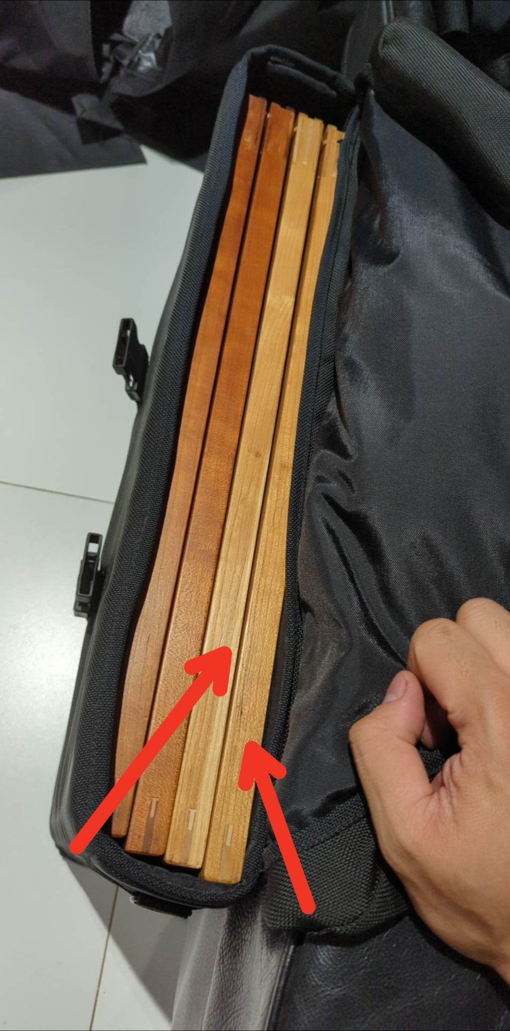

Chiming in on an old thread—I have acquired two like new 14x17 S&S film holders and what I noticed is that film doesn't go in all the way, hence there is a lip of film that stays outside of the overall area for the film.
I have two older S&S holders which do not have these problems (sharing an image of the problematic ones, not sure which is cherry which is walnut).
