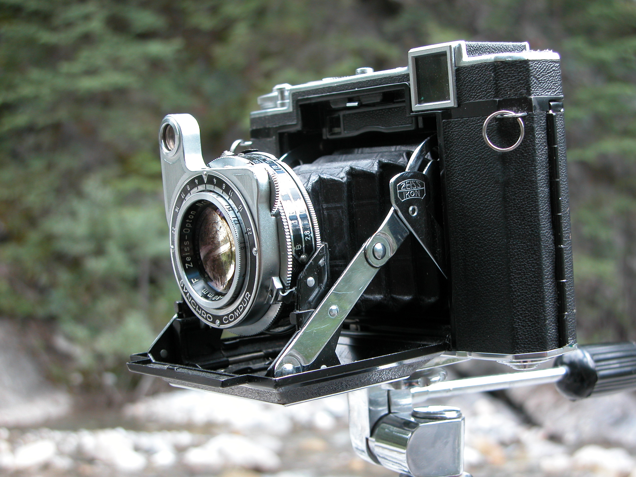

Super Ikonta B. Coated Tessar no meter.
Acceptable at f2.8, great at f5.6, f8 and f11 superb.
