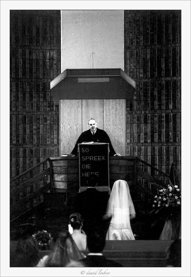

Here is one of the images, exposed at ~ISO 50 (using an Olympus OM-1n and Zuiko 90mm Macro at f/2.0), and printed in the darkroom (5x7 inches, Ilford MG IV satin paper).
The grain is really quite fine when you consider this is actually an ISO400 film with massive head an shoulders on the tone curve. I also pushed this film to ISO1600 and beyond in really dark circumstances, and it did not too badly. I still prefer HP5 or Kodak TMZ P3200 for these situations, but as a one-film-fits-all solution it's very compelling, I enjoyed using (and printing) it, it's very well-behaved when in an enlarger.

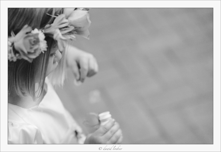

This second image was exposed at at least ISO1600, unfortunately the scan I did was not great, lost some of the highlight details because I was in a hurry, but it's there in the print. This is at the opposite extreme of using this film's working range as I understand:
(Also OM-1n, and also Zuiko 90mm Macro at f/2.0)
