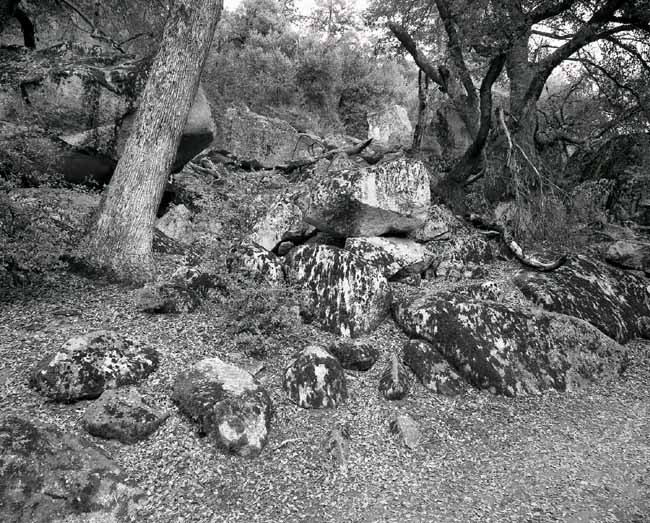

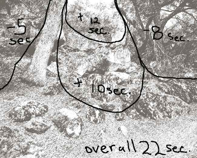

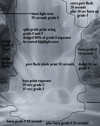

I thought that it may be an interesting challenge for us to show our "Vision" in it's final form and at the same time show each stage in the process of realising that vision. Finally, to write a short explanation of our reasons for making the image in the first place.

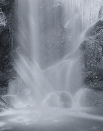

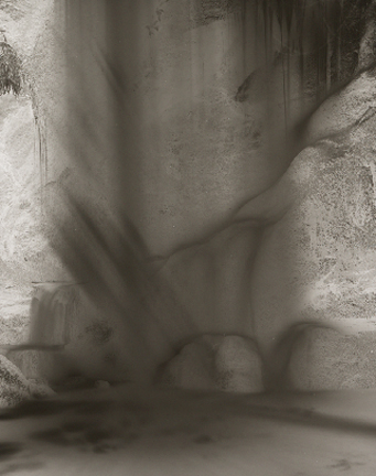

Here's my offering to start the ball rolling.
Roughting Linn 2004
This place is my personal fantasy haven that I visit whenever I can, and often go there to cut myself off from the world and sit and think over problems. Roughting Linn does not look like this in reality, it is a quite dark place being in a small gorge and surrounded by trees. In the 30 years that I have visited this place I've always seen it as a place of light and have tried to convey that in all the prints I've made of it.
Images from left to right
1) Scan of the 4 x 5 negative developed in Prescysol
2) Pilot print on Ilford Warmtone 3 filter (no burning or dodging)
3) Final print on Ilford Warmtone split grade printed using 0 and 5 filters
4) The print plan

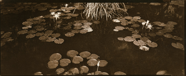

alright heres my attempt:
Mayfield Park: lilly pads
This is an ongoing project for me. I have been visiting this small park for almost the entire time Ive lived in Austin. A friend of mine who also does photography used to tell me about the wonderful flowers and gardens that he would go photograph at during his lunch break. I was new to photography and shooting alot of slide film with both my 35mm and my 120 camera. I started venturing there and took slide upon slide of the gorgeous foliage.
maybe 4 or 5 months ago when I went back there and started to see alot of images I wanted to capture in black and white. I started working with my 8x10 and going up there almost religiously at around 5-6pm everyday. I was getting some images I really was pleased with. after spending a while I started working with my 7x17 camera there and really felt comfortable with the format and the location. I started really seeing alot of images that fit it so well.
as an aside, this garden is rarely visited by people on occasion there is a wedding photographer doing engagement photos or the occasional family will wander through with their children. but all in all, alot of the numerous hours Ive spent there have been in solitude, aside from the noises of the peacocks. Its a wonderful place to sit and write in my journal and contemplate dillemas, rough patches in life, etc.
This particular image is one I saw almost instantly and wanted to capture. it was around 4pm when I saw it and I knew from the get go I would be making a Van Dyke print of it (what Im concentrating on with this series). I have become familiar with the process and its range of values etc. I knew from the get go I wanted the water to appear the darkest possible tone. Zone I and II. so I had to wait and hope that the dropping sun would allow this and also to still allow the lillys to register as pure white.
I chose to frame the image in the way it is because I was moved by the bottom lilly that hadnt blossomed the two groups that seemed to balance each other in the left 1/3 and right 1/3 of the frame and really like the sunlit grasses peaking through the top. with their reflection showing the parts that have been cropped out of the top. almost felt like a sense of symetry in what normally feels like 'natural' chaos.
Honestly this image is one of the few that was a true success from the standpoint of seeing with "van dyke" eyes and creating a result that adequately expressed what I initially hoped for.

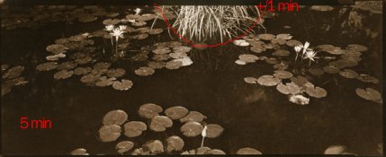

image 1: test strip
image 2: Working print - showed I would need to burn a little because I didnt want the grass to take up too much attention.
image 3: the final print with 5mins of UV exposure and 1min of burning the bit of grass. (yes I actually do on rare occasion dodge/burn my contact prints - *ducks*)

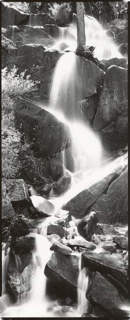

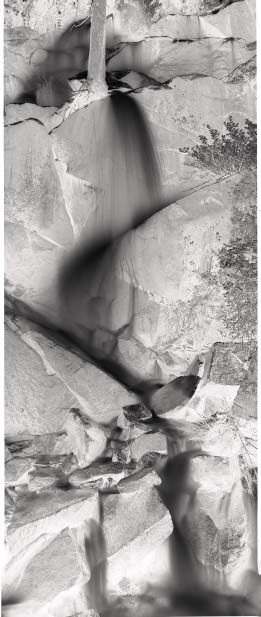

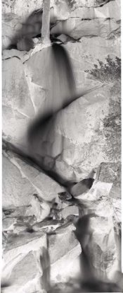

The case in point I've chosen to share was on one of those trips. I was traveling to the SF bay area to meet up with APUG friends. I didn't know how my time would work out as I hadn't traveled to the bay area that way before and I needed to be there sometime in late afternoon. As I passed this scene at 45 mph I said to myself I'll stop here and photograph tomorrow on the way back home. I had the 7X17 with the 305 Dagor set up in my minds eye 24 hours before I exposed the image.
The scene is where Yosemite Creek crosses highway 120. When I returned the following day, true to plan, I spent a pleasant hour here. Turned out I couldn't get the scene I wanted with the 12" lens so the 270 G-Claron went on instead. I needed to have a sense of where the water tips over at the top, and where it pools at the bottom.
To answer your questions more fully though. Yes, no. Sometimes it's so easy to see and plan exactly what you'll get as it's on the GG. That's why I switched from the 12" to the 10 3/4". OTOH, sometimes I'm playing with a Verito or a Petzval and those lenses can be full of surprises. Perhaps in a few years I will have used them enough to know from what I'm seeing on the glass approximately what I'll get. The swirly bokeh picture of the 1950 F1 Ford truck (in my gallery on site) was done later the same day with the 18" Verito, and it was full of pleasant surprises. But I got exactly what I had visualized......pretty much :wink:
