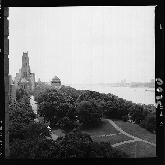

Okay, here's a scan from my second test roll. TX, EI 6400, Y2 filter (3x), 5 min, 75 deg. F, 2 inversions every 30 sec. (Sinar F, 105/2.8 Xenotar, 1/400 sec., f:16, DaYi 617 back masked to 6x9).
If the scanner is to be believed, base fog was down by 20% from the first roll, and Dmax was more controlled. Less agitation was good for more compensating effect in the shadows. Grain was improved over the first roll, and there might be some grain masking effect going on. I included a detail crop scanned at 1000 dpi and scaled down a bit to fit the APUG size limit to show the shadow detail and give an idea of the grain structure.

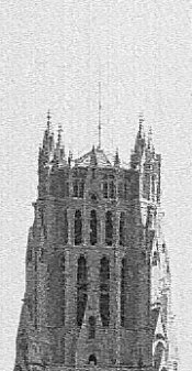

That looks good. Is the grain in the sky chunky? I couldn't see any in the scan. Certainly looks like a developer worth experimenting with.
Looking with a 6x loupe, the grain in the sky seems big, but I'll know more when I make a real print, which would show if there is a grain masking effect. Here's a neg scan at 1000 dpi, full size, which also isn't an indication of how it will really print, but gives some idea.
I don't think I'd use this for 35mm. I'm mainly interested in using it for 4x5", but if the grain is comparable to ABC pyro or better, I'd go as small as 6x7.

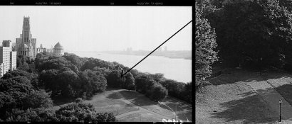

Here's a scan of the EI 3200 test frame with a detail at 1000 dpi on the right.
Base fog is down another 12% from the second test roll, and it would be better if I were using fresh film (expired 7/2002). These negs also show some more relief than the first batches.
