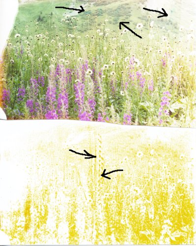

I've been having some problems with RA4 printing that I've never had before. I'm using a Nova 4-slot heated processor, Tetenal RA4 chemicals and Fuji Crystal Archive paper, at 22C.
First, I noticed that there were what seemed to be cyan 'splash marks' appearing at various locations on the surface of the print, so decided to give the tank slots a good clean in case there was contamination of some sort.
I soaked the slots in a dilute solution of household bleach for 24 hours (others seem to have tried this with no apparent problems). The top of the developer slot still looked rather mucky so I tried some Muc-Off bike cleaning spray (a biodegradable alkaline solution - perhaps similar to Nova Tarbuster) that seemed to work well. After many rinses and standing with fresh water in the slots for 24 hours, I then drained the slots and re-filled with the existing chemicals - maybe not the best idea.
Now I find that the prints are almost completely white but with a pale yellow image discernable in the darker parts. There are also still marks that look similar in shape to the 'cyan splashes' that I had previously, except this time they are pale yellow.
Does anybody else have any experience of this, or know what might be going on? :confused:
All advice gratefully received!

I'm attempting to attach a before-and-after scan to show what I mean (never tried this before so I hope it works!).
The top section shows a test strip on which I have marked the 'cyan splashes' with arrows - I hope they show up after being shrunk and converted to jpeg. The white area at left is the shadow of a hand holding the paper. Please also note the 'flame' effect along that edge (which was towards the bottom of the Nova slot) and also a similar effect along the wavy edge, which had been cut with scissors in the dark.
The bottom section shows the result after cleaning the tank: this time a single exposure of 20 seconds - about twice the length of the longest test strip time. The arrows show a mark that may be caused by the waffle pattern of the tank wall, perhaps? Previously, these marks were appearing as cyan before I cleaned all the tank slots (although there isn't a waffle mark in the top section on that particular test strip).
I suppose I must have failed to rinse the slots sufficiently after cleaning, but I'd still like to know the cause of the 'cyan splashes' which I have not had trouble with before.

Thanks for that I now can see what you mean. Yes , it is one colour only and a very faded picture. If it is caused by dilute household bleach contaminating the developer then given there is 1L of dev in the slot and the dilute bleach has been further diluted and drained away then household bleach even in minute and very highly diluted quantities must be devastating stuff. So devastating that any RA4 users of a Nova should steer clear of any household bleach at all.
As you may have gathered from the above I still remain doubtful that at very high dilutions and flushing, such bleach remains the culprit.
Maybe photo chemical engineers will add a response. I hope PE and other knowledgeable experts can shed some light on this.
When you do the scrubbing you might want to drain the water jackets first and tip Nova at an angle so the water going into the top is all running out at the bottom and then to make sure the empty slot is dry I'd use a hairdryer with a narrow blower to ensure the slot is bone dry before filling up.

Taking note of advice earlier in this thread, I ditched the existing chemicals and gave the Nova tank another clean with a scrubbing brush and rinsed it thoroughly with copious amounts of running water (in the bath, with the shower hose!).
Then I made up new working solutions from the same bottles of concentrate as the first attempt and had another go at printing. This time, the prints came out dark blue. So I re-did the colour calibration and have now ended up with 'perfect' prints, using exactly the same filter settings as I was using at the start of the year with a different box of paper.
So I have to conclude that the first batch of working solution was not right at all, for whatever reason, and maybe remnants of the initial cleaning process were sufficient to finish it off completely (this is all just a guess really, I'm not a chemist).
As for the 'cyan splashes' on the original test strips, I wonder if these were caused by touching the surface of the paper. The darkroom is in an unheated garage (but an integral part of the house) and was really quite cold last week. Usually I bring the paper into the house to warm it a bit before printing, but I forgot last week and I wonder whether the cold, gloss surface attracted some condensation in the same way that placing fingers close to a cold glass surface can sometimes do.
So the problem has gone away, even if the mystery isn't completely solved. I guess the moral of the story is to rinse very thoroughly indeed after cleaning Nova tanks!
