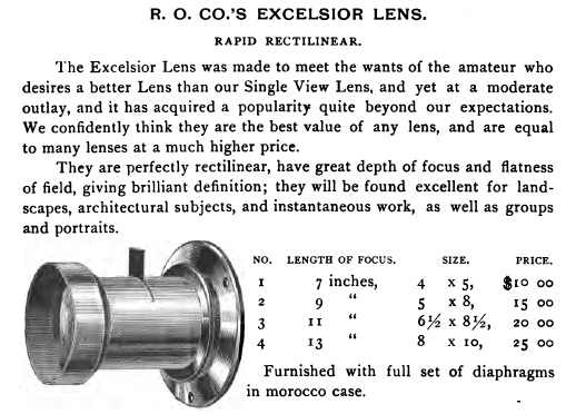

The Excelsior was a trade name for both a camera and lens sold by Rochester Optical Co. The lens is a 4 element Rapid Rectilinear type. 1889 Catalogue page attached.
Dan
