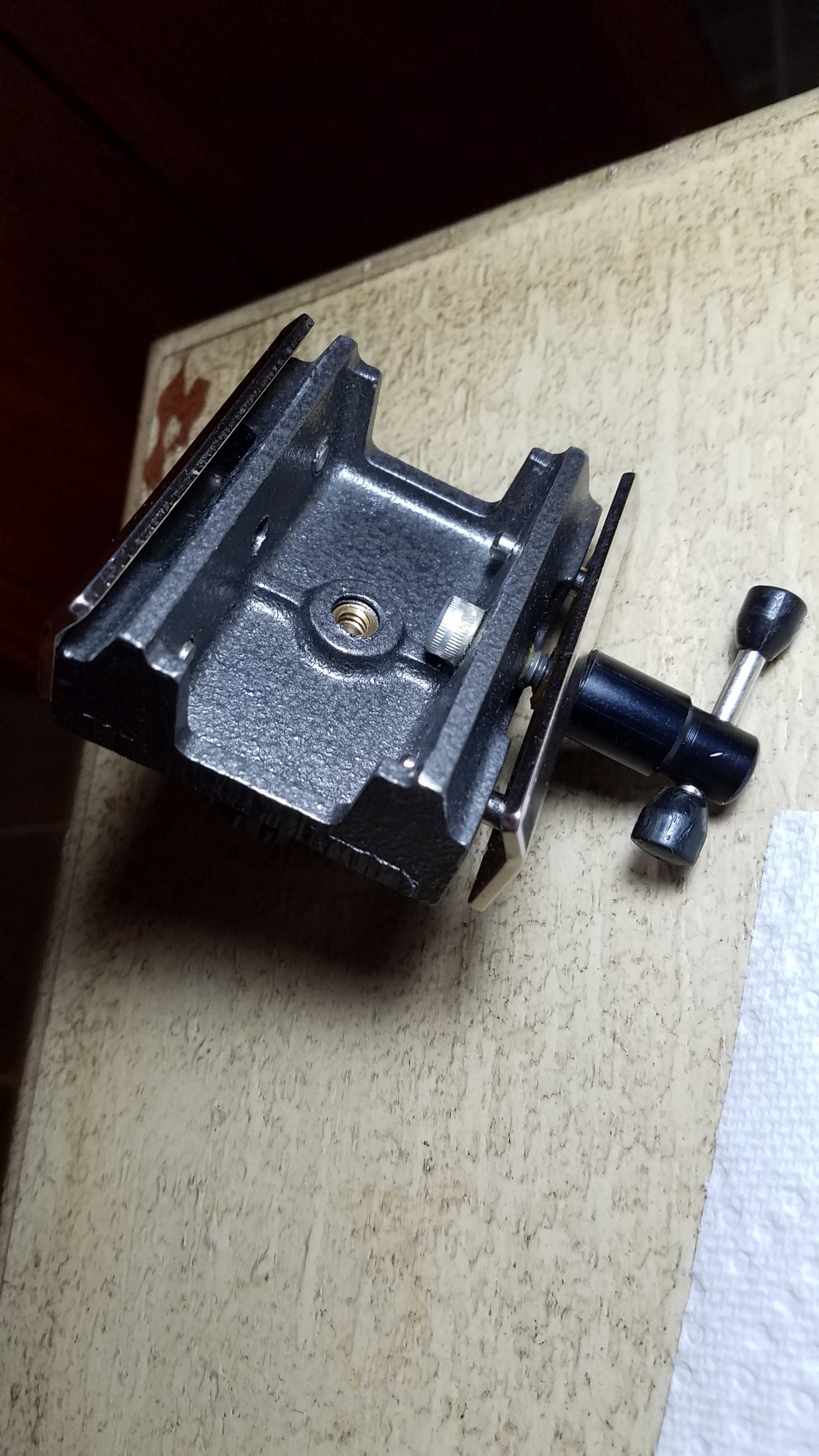

Mine broke. I need another. I have an old Gitzo 3-way head and a Chamonix 45H-1 4x5 large format camera. I also will be shooting with a Mamiya RB67 medium format camera with the same tripod.
So which quick-release system works well for both? Thanks.

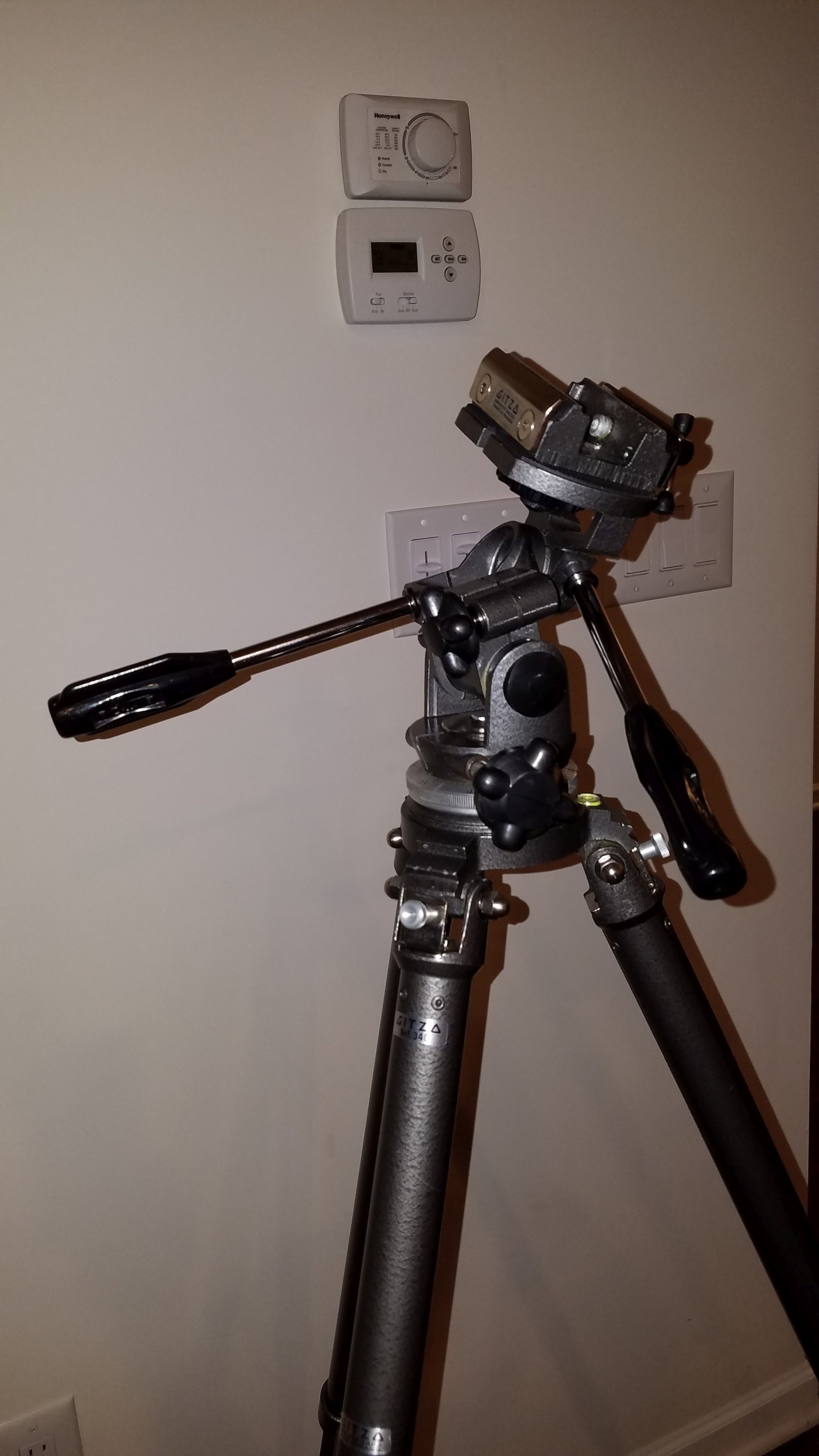

See pictures. The quick-release broke. The picture shows original clamp and Gitzo Tripod. The release plate is about 2"x3". I mount a Mamiya RB67, medium format, or a Chamonix 45H-1 large format 4x5 camera.
View attachment 260268 View attachment 260269
I do not understand from this photograph. What is broken?

Your tripod looks like one of the fine French units from the old days.
