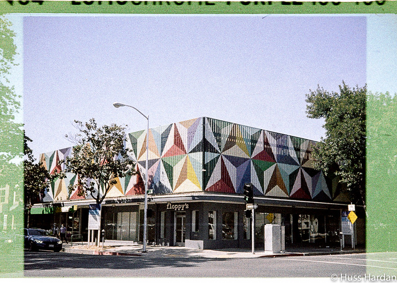

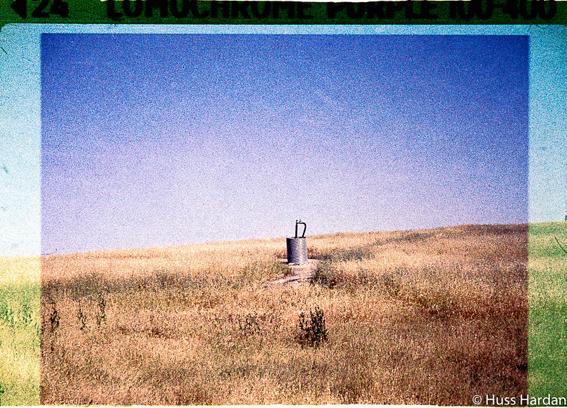

Flip side is I can just got out and buy ready to go 110 cartridges, in a variety of flavours.
The lovely Lomo Metropolis in 110:
2nd is Lomo Mistaken Identity, which is actually Lomo Purple or Metropolis with incorrect film markings. This one ended up being Metropolis
There are two fantastic 110 cameras out there - the harder to find Rollei A110 (my favourite), and the excellent easy to find Pentax Auto 110.
Convenient for sure, and if I’m being honest, much less chance of scratched film. I always notice how clean your shots are. Cleanliness is the constant battle for film reloaders. Many a time nose grease has saved my negatives from fine scratches on the base side.
Great shots, by the way.
