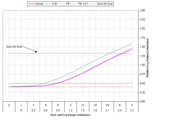

I've been trying a variety of developers over the past year or so and it's been very interesting to experiment for me. One that I hadn't gotten around to until just recently was Sandy's PyroCat-HD. I don't keep Potassium Carbonate around for anything else but I finally mixed up a batch with the Sodium Carbonate version. I hadn't realized that the pH was so high on this until I checked tonight (about 11.0). I had noticed some emulsion swelling and this is what got me checking pH levels. Is this normal? Is it more apt to occur when using the sodium carbonate? The first of two rolls was done at 80°F as listed at the Massive Dev Chart and I thought this may have been somewhat the cause but the second roll exhibited some swelling, too (not as much, though).
I've only tried it with 35mm HP5+ on a couple of test rolls so far and had a bit more fog than I expected at .40. Most of my B&W is done on medium format so some of this will be at better levels on that. I assume there are some long-time users of this in here who can fill me in a bit on these questions. I've attached a curve from shooting at 400 and 200 (blue line) 13 min at 70°.
The pH of 11.0 sounds about normal to me. I usually get about 10.9 with the 1:1:100 dilution using potassium dichromate so we are getting almost identical results in terms of pH.
High pH will indeed result in some emulsion swelling so if you see any problems drop the temperature, or alternatively use the 2:2:100 for faster develpment times at a lower temperture. I recommend processing with Pyrocat-HD at 68-72º F.
Sandy

Uh, Zone XIII Goal?.......Did you by any chance mean VIII goal?
Clearly you have a lot of fog and your exposure as well as your developing times were too high. From the curves you presented I would say you need to rate the film at 800 if you plan to continue using the same developing times and temperature. If I was you I would rate the film at 400 and reduce developing time by 30%. I would go with King's suggestion and use 70º F with about the same time, the high temp might have been the cause for the swelling.

Jorge... I've used that old spreadsheet for a long time and never noticed the labeling error on the chart. Yes, it is supposed to be Zone VIII. For my equipment/materials, it seems that if I keep my Zone 8 in that ballpark, I'm not struggling to hold highlight details. I should have deleted it before posting as it doesn't really pertain to my questions anyway.
After totally drying, the second roll (at 70°) had very, very little emulsion disruption.
I can't see where up-rating the film is going to do anything but lose more shadow detail and my mid to highlights are falling right where I would like them to be. The ideal usable EI for HP5 and my equipment would seem to be 200...? What am I missing here?
In some frames I took of general outdoor scenes, it seems there is quite a bit of detail in the shadows, the grain is quite fine and I like the stain color for VC (I haven't printed anything yet, though). I got very little difference in blue channel curves even though there is obvious stain color. I'll back off a bit on the time and try some different agitation scenarios and also run some medium format and see if the fog settles down for me.

Craig, I am only going by the charts you presented. It seems you EI falls in Zone III instead of Zone I. This tells me you can give less exposure and less development and basically end up in the same place with a some what thinner negative that would require less enlarger exposure. The advanatge would be that you would enjoy a "faster" film. You could rate HP5 at 400 instead of 200, and meter your shadows accordingly.
In the end pay no atention to me, yo need to do what is working for you and it seems to me you like a somewhat denser negative than it is required.
