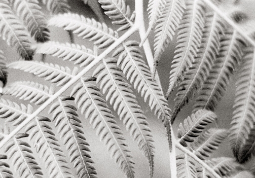

Pyro HD sample
I think Pyrocat HD is an extremely versatile developer, which I've used for anything from contact printing sheet film to graded paper, and enlarged from 35mm negs to variable contrast paper. Attached is an actual size scan (excerpt) from a 12x16" print from 35mm FP4+.
I concur that no developer is a silver bullet, many other things have to coincide to get what you want, but if you're looking for a developer that produces amazingly sharp negatives, and holds the grain back in the stain somewhat, AND is able to build expand and contract well - you have a very fine product in PyrocatHD. It's cheap too.
