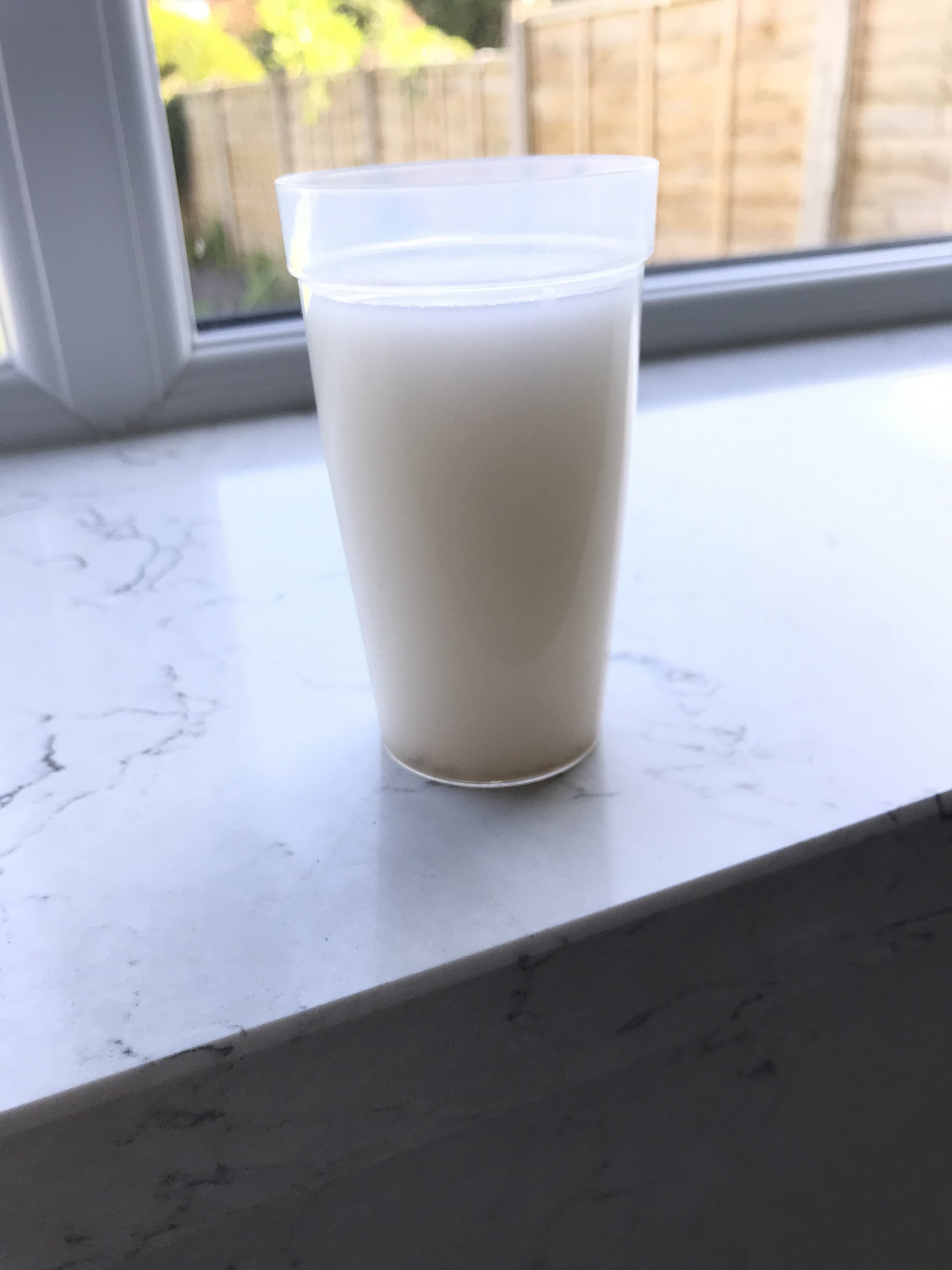

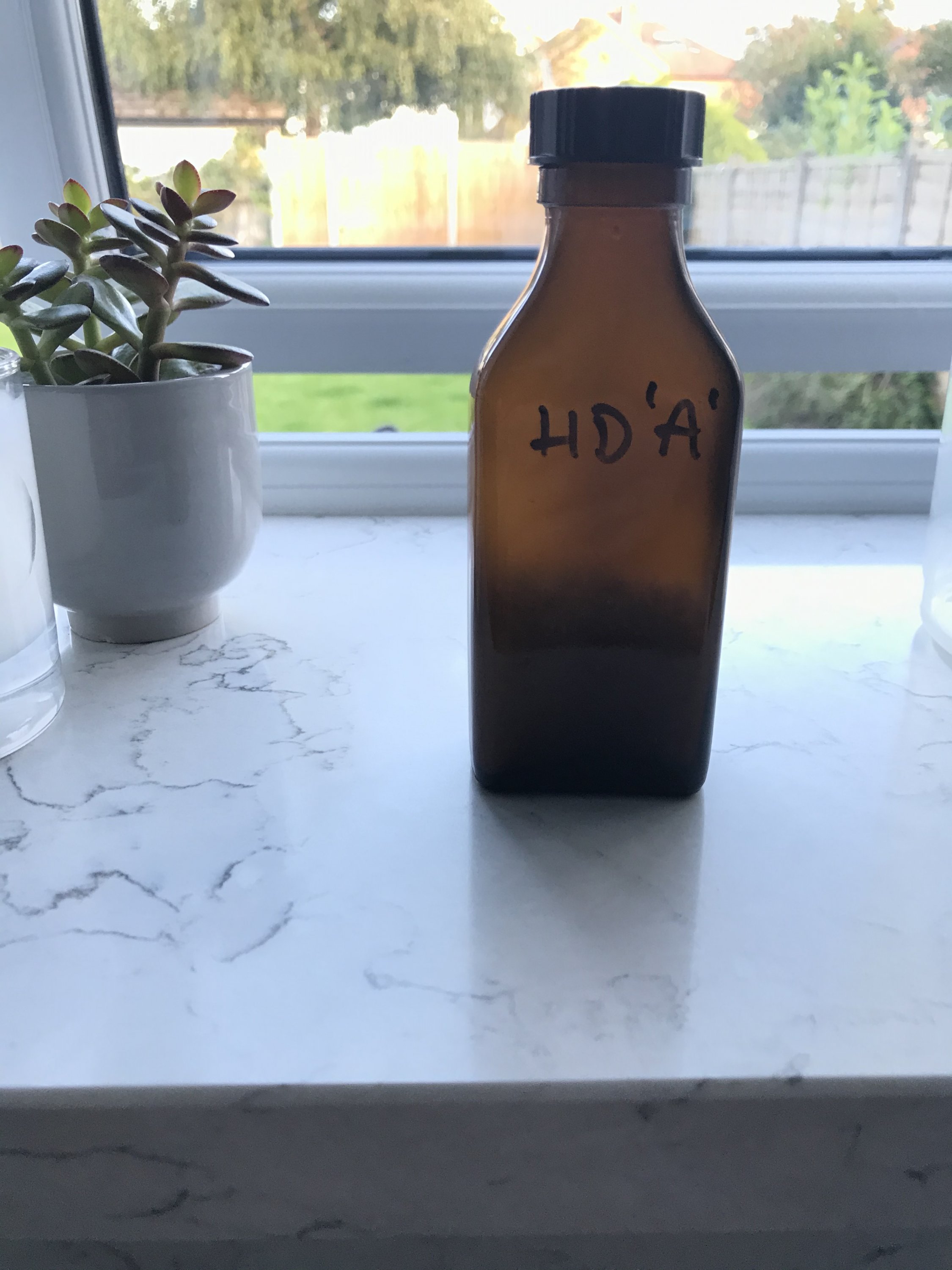

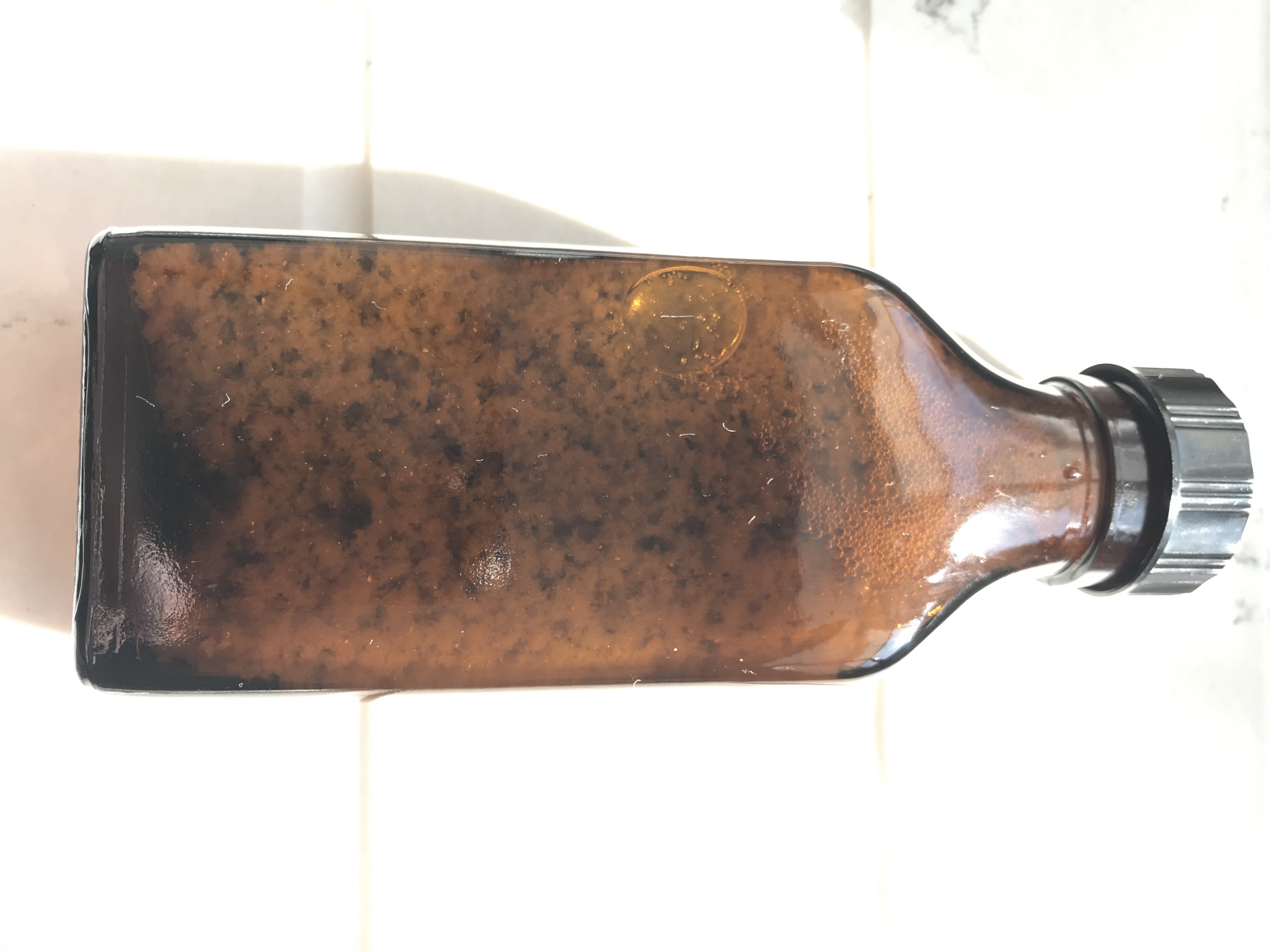

Hello all,
New here and dabbling in processing my own films.
I have just mixed some Photographers Formulary Pyrocat HD and believe I have a problem. When mixing The chemicals for Mix A the solution became gunky (not sure if this is a chemical term?), see attached photos.
I mixed at approx 125 F with de-ionised water. This is the second batch that has turned out like this, so either I am doing something very wrong or it’s the chemicals. Any ideas?
Can the solution still be used as it is, as I seem to be throwing away money at the moment ?
Many thanks Diane

75ml to mix and top up to 100ml. The bottle in the original post is 100ml size. I live in North Wales, unfortunately!
There's only 10g of chemicals in the 100ml and all easily soluble, so that's very odd. I wonder if the pack's incorrectly labelled. What's the weight of Part B ?
I checked the PF website and noticed they use the wrong weight of Potassium carbonate in Pt B, should be 750g in 1 litre of water, May be just a mistake in the datasheet. I've 30litresbof Part A on the shelf, and mixing more next week.
Ian
I am adding the chemicals one at a time, as they are listed on the data sheet and, it is not until I add the potassium bromide that it starts to precipitate/ go gunky. I am trusting that each packet of the different chemicals has been weighed accordingly, that is, I am not re-weighing them.
Maybe I should mix all the dry chemicals together and then add the water.
Part B looks ok, 75g in 100ml.
I have one packet left ...

PF had a bad batch of Phenidone that would not mix. Let it sit in the bottle a few days and see if it will go into solution. PF will replace it if you email them(Sometimes). If your part B is correct Dont throw it out. You can later experiment with other Pyro formulas and they all use same part B. Pyrocat M is easy to make and so far is more stable than HD for me.
Eric, you're probably right about it being a bad batch of Phenidone, everything else is very soluble. If made up with reasonably fresh Metabisulphite Part A last over 3 years in a pet full bottle. Bisulphite is lower grade and not as Good a preservative.

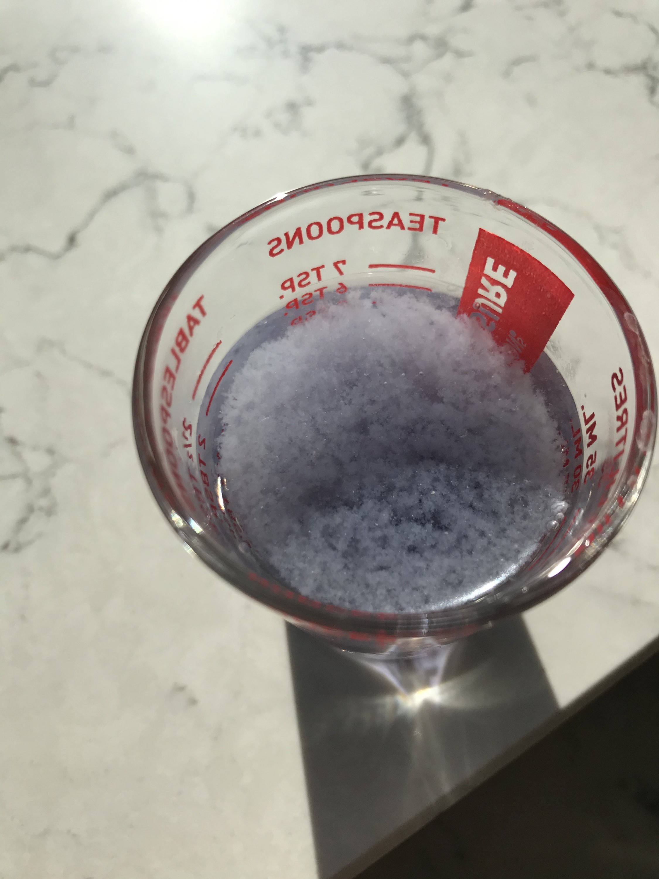

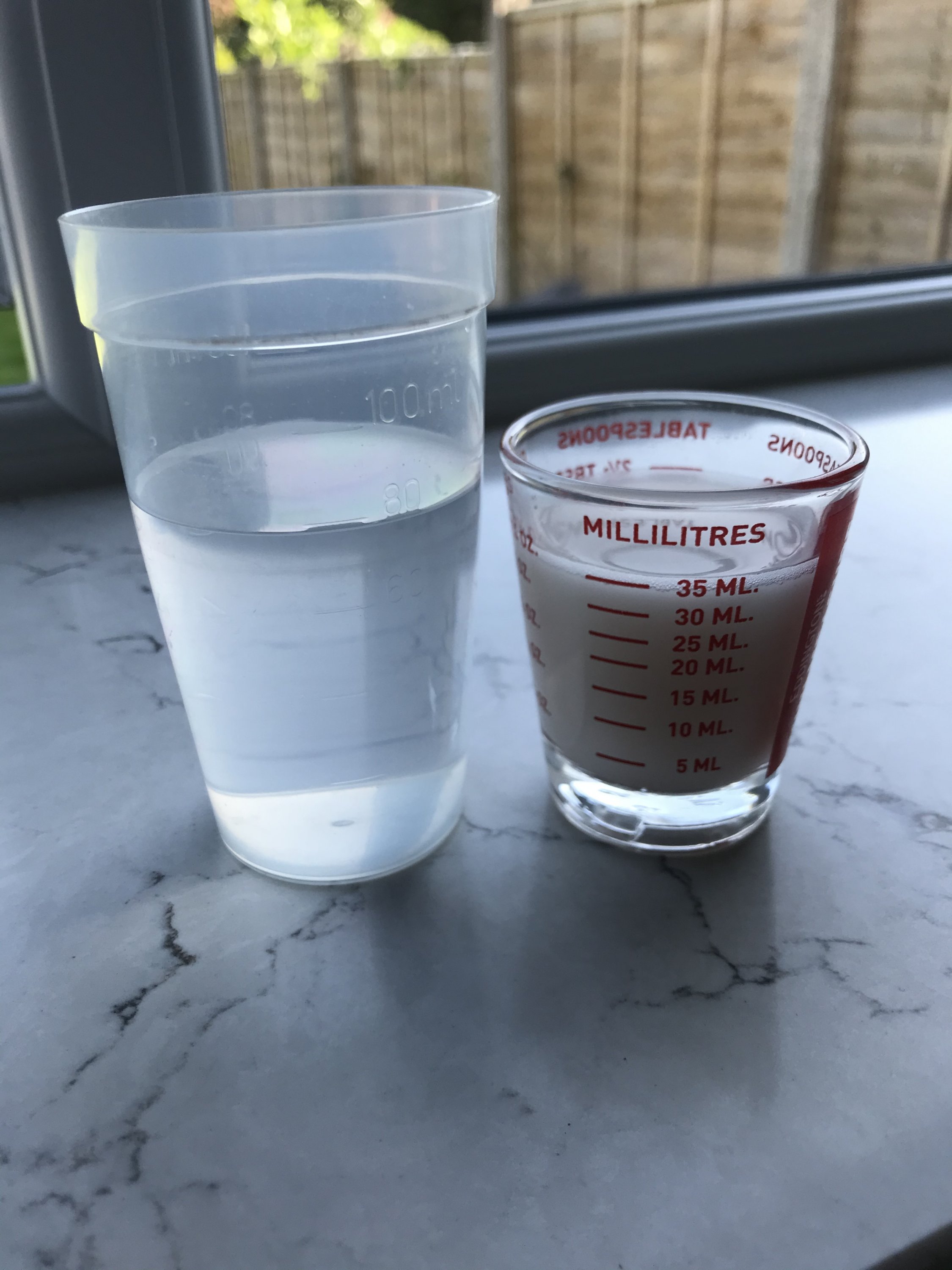

Should Part A mixed look like the milky solution in the left hand picture ?
I mixed the phenidone separately then the other chemicals - the picture showing two solutions. The phenidone is mixed in the graduated glass on the right.
That looks like the Phenidone is in suspension, in 40+ years of mixing developers etc from raw chemicals I've never seen that happen and I've used quite a lot of Phenidone. It's possible adding some alcohol would help dissolve the Phenidone, it's more soluble in Glyco and other alcohols than water.
First though try warming the Phenidone solution it may then dissolve.
Ian
This is the bottle after 2 hrs, Phenidone very much in suspension. Very frustrating!
I will warm it again in an attempt to dissolve it, but it was prepared in warm water and has stood for a while in a warm water bath after mixing.
I will contact PF and ask if they can offer any explanation.
Thanks for your assistance today.
Sorry you've been having issues with the formulation. It may well be a dodgy batch of phenidone; possibly pre-oxidised to some extent, or maybe it has been crystallised in such a way as to give it lower than usual solubility in water. You could try adding some isopropyl alcohol (say 5-10%) of a high purity to the part A and see if it dissolves then. Either that or seek a replacement from PF.
Don't give up, as Pyrocat-HD is a magnificent developer. You may not be aware, but there is in fact a UK seller of the pre-made mixtures (and furthermore they sell it with Part A mixed in glycol, which gives it a longer shelf life):
