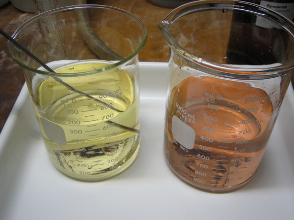

I think I should be a little more specific about my explanation...
So far, I have only used FP4 (Arista Pro and Defender soon) for 4x5 work, though it is not that I shoot a lot with 4x5. I have processed films from the same box about three months ago (that is how often I use 4x5...), and they had an obvious brown stain to it. Also, the edge is a little more pinkish than what I got last night.
I personally have never seen any other negatives developed in Pyrocat than mine, so I cannot tell what they usually look like (or should look like). So, I just took pictures of the different things that I am talking about.
First is the color of developer. This yellow one is from processing FP4, and the other one is used water stop (after development). After posting this message, I processed 8x10 Tri-X which I use a lot, and the color of the developer was as usual.

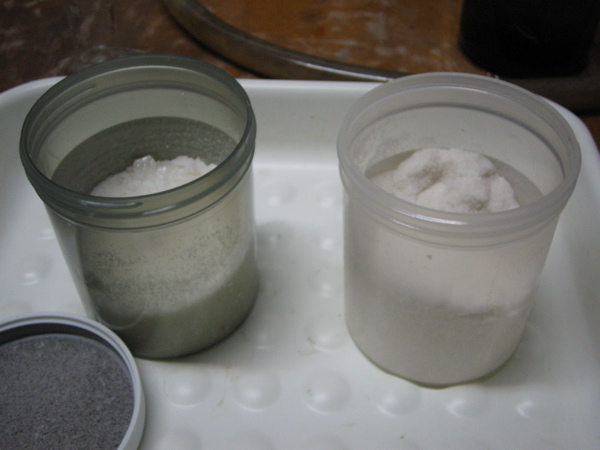

The next one is the color of the container which has catechol (next to Tartaric Acid). The darker stain is very apparent.

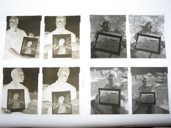

Now, I start wondering this particluar one is how it should be and maybe ones before this batch had too much stain so to say. Here's the comparison on a light table. The negatives on left are previously developed, and ones on the right is from last night.
I do not have a densitometer, so I cannot tell for sure, but ones from today seemed to have a less general stain, and the it has a pinkish base to it. The others have a very clear base.

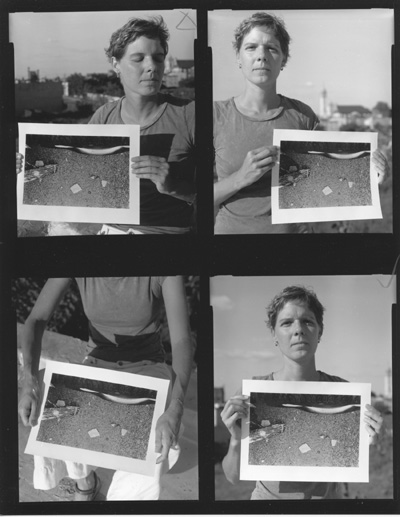

Hi everyone,
To tell you the result first, they both do print fine. At least visually to my eyes. My issues is that they look so different even though they are from the same box of film. It is quite true that like Sandy said (well after all he is the one who came up with this) the stain can be very deceptive, I must say.
This was fourth batch of Pyrocat that I made so far. This time it looks quite different in terms of the color of stain. So, I was wondering if I did anything so different when I mixed the developer this time (well the only things is that I heated it to 60 degree in celsius before I put any chemicals).
Again, they do print fine. So, I guess they are OK...
