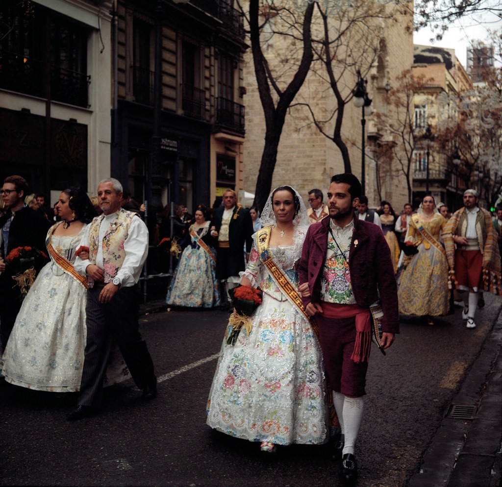

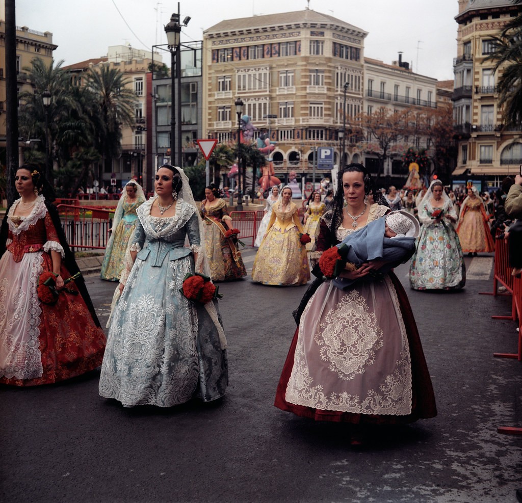

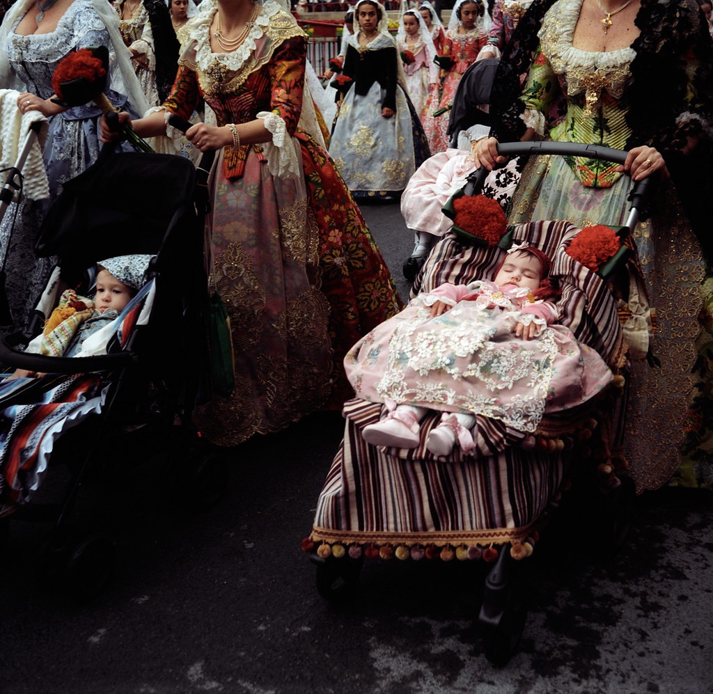

I attach bellow some samples of Portra 400 exposed to ISO 800 and pushed during development. Photos taken with an 6x6 Iskra in a cloudy day with very flat light.
I have pushed this film only a couple of times because the results, specially the saturation, are not for everyday photography.

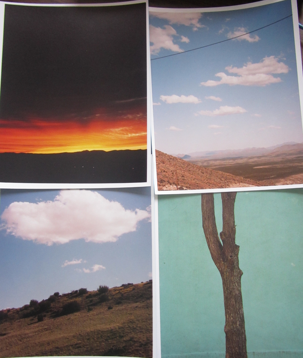

Eleven months, to be exact. I only shot one roll of Portra at 800 and told the lab push develop it one stop-which they said, based on their experience, would be an extra 15 seconds.
This is just an unaltered quick point and shoot snapshot of the first prints I made from that roll. Considering all the whining and griping I did here, https://www.photrio.com/forum/threads/portra-400-blah.172917/
I'm pleased with the contrast and lack of white cow excretions. There is a lot of haze and dust in the upper right one.
I'm encouraged, especially considering the Ektachromes I got back at the same time turned out less favorably. I think with Portra being more forgiving I'm going to stick with it for the most part this year, or until its priced out of reach next year.
