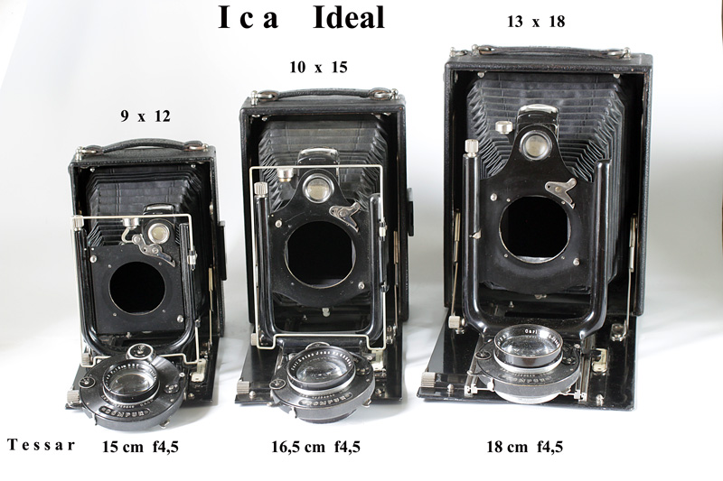

    Hello,
    Here are some ICA numbers, from earlier to later cameras :
    _ Cupido (without number of type, but it's a 6x9 format) s/n 87xxx (no letter, maybe a renamed Huttig, body is named ICA) ; lens Tessar Carl Zeiss Jena 112 mm f6,3 s/n 96xxx (~1905-1908) ; shutter Compound s/n 96xxx
    _ Reicka (folding 10x15, no number of type) s/n 81xxxA (~1909) and, smaller, E2 (maybe a factory modification) Tessar CZJ 16,5cm f6,3 s/n 385xxx (~1920 I think it was changed) Compound without s/n ; it strongly looks like Wuensche foldings, but has ICA named body.
    _ Favorit (square folding 10x15, no number of type) s/n A50xxx (1911, patent date inside body), Tessar CZJ 16,5cm f6,3 s/n 140xxx (~1909), Compound s/n 90xxx.
    _ Reicka (folding 10x15 different from the above, no number of type) s/n A54xxx (~1911), lens ICA Doppel-Anastigmat Lloyd 165mm f6,8 s/n 143xxx, Huttig Compound without s/n.
    _ Ideal 385 (folding 13x18) s/n A98xxx (1911, patent date inside body), Tessar CZJ 21cm f6,3 s/n 142xxx (~1909), Compound s/n 203xxx.
    _ TriX 311 (folding 10x15) s/n B89xxx (~1912), ICA Novar Anastigmat 16,5cm f6,8 s/n187xxx, Compound without s/n.
    _ TriX 185 (folding 9x12) s/n C14xxx (~1913), ICA Novar Anastigmat 13,5cm f6,8 s/n 245xxx, simple shutter without s/n.
    _ Triplex 410 (folding 13x18) s/n D87xxx (~1914), Tessar CZJ 18cm f6,8 s/n 187xxx (~1912), Compound 221xxx.
    _ Ideal 205 (folding 9x12) s/n F62xxx (~1919), Tessar CZJ 13,5cm f6,3 s/n 313xxx (~1918), Compur 268xxx.
    _ Ideal 111 (folding 6x9) s/n F77xxx (~1919), Doppel-Anastigmat Hekla 12cm f6,8 s/n 473xxx, Compur 267xxx.
    _ Ideal 325 (folding 10x15) s/n G31xxxK (~1921, modify/repair ~1925), Tessar CZJ 16,5cm f4,5 s/n 623xxx (~1923)Compur 323xxx.
    _ Ideal 385 (folding 13x18) s/n G86xxx (~1922), Tessar CZJ 18cm f4,5 s/n 418xxx (~1920), Compur 316xxx.
    _ Ideal 111 (folding 6x9) s/n J26xxx (~1924), Tessar CZJ 10,5cm f4,5 s/n 489xxx (~1922), Compur 330xxx.
    _ Trona 212 (folding 9x12) s/n J74xxx (~1924), Tessar CZJ 13,5cm f4,5 s/n 599xxx (~1923), Compur 375xxx.
    _ Orix 308 (folding 10x15) s/n J79xxx '~1924), Doppel-Amatar 16,5cm f6,8 s/n 362xxx, Compur 288xxx.
    _ Ideal 325 (folding 10x15) s/n K68xxx (~1925), Tessar CZJ 16,5cm f4,5 s/n 623xxx (~1923), Compur 393xxx.
    Following letter , L, is for the first Zeiss Ikon cameras made in 1926.
