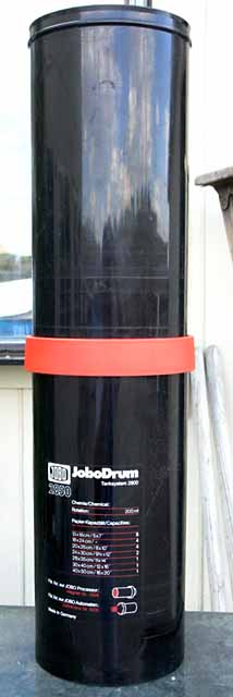

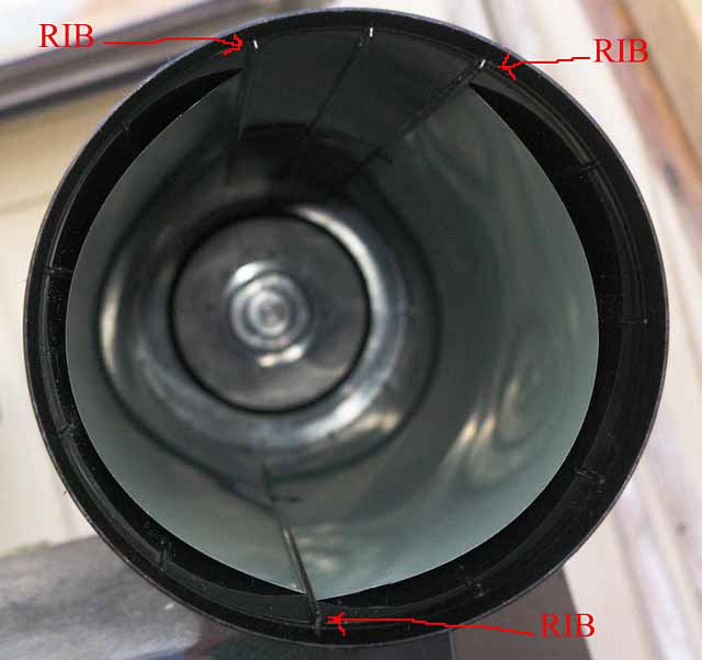

Photos of how 2 sheets fit perfectly in the Jobo 2850 drum. These aren't an expensive drum. 2 8X20 sheets fit the same way but go all the way to the far rib. I get perfect even development every time. No insert needed. I don't think the 1220 would work in this though.
Hi Jim:
I got into Carson City yesterday morning. I have a lot of gear with me and I'm ready to shoot!
Regarding your post, are those 7x17 negatives. They look like they fit well. How much chemistry do you put in there to cover the negative? Do you process it on a JOBO or rotary processor or do you do it by hand?
