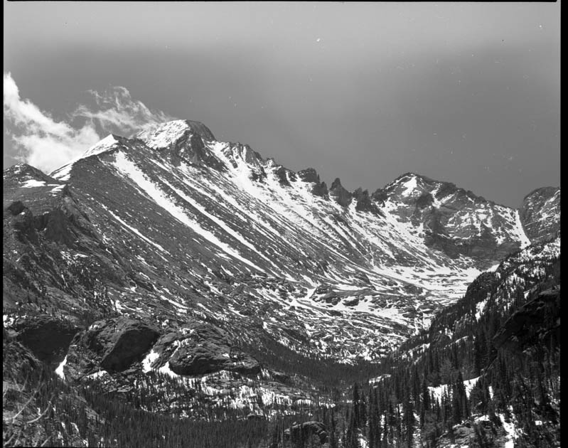

I'm having an issue with my 120 processing I hope someone can help me isolate. On the last few of rolls of B&W film (Acros, Pan F+, Delta 100) I'm getting inconsistent development at the top of the rolls, and sometimes both the top and bottom. This only happens with B&W film that I develop. The color film (Ektar and Velvia) processed by my local lab do not exhibit this, so I'm sure it's my developing and not the camera (Bronica GS-1 6x7 back). I've used both plastic and stainless steel reels. The attached image was shot on Fuji Neopan Acros 100 at 100 and processed in Perceptol (1+2) for 16 min at 75F. Any ideas?
TIA.

Assuming the light (too dark in negative) area at the top is the problem, then it's likely an agitation issue. Proper agitation can be tricky to describe, and depends to some extent on the tank you're using. Personally, I agitate continuously by inversion for 30 seconds, then do four or five inversions every 30 seconds thereafter. Each inversion (complete turn upside down and back rightside up) takes about 1 second, or maybe just a bit more. After every agitation cycle, I rap the tank to dislodge bubbles and give it a slight twist (about 90 degrees).
I've seen descriptions of agitation that are more and less vigorous than mine. I've seen claims that under-agitating or over-agitating can produce the problems you seem to have. I recommend you shoot a few test rolls and try radically altering your agitation routine. You may also want to check YouTube; I'm sure there are demonstrations that could be more informative than a written description, but I don't happen to have any links bookmarked.
Another thought: Are you using inversion agitation, agitation via a rotating stick, or some other method? Most people seem to prefer inversion agitation, but some people prefer using the rotating stick. Most (all?) stainless steel tanks lack the stick for that style of agitation, although there are SS reels for some plastic tanks. A few (mostly elderly) plastic tanks aren't built for inversion agitation. Most modern plastic tanks can use either method. If you've got such a tank, you could switch from one method to the other.

It does sound like an agitation problem, varies between top or bottom, means that the reel is loaded one way or the other at random. Standardize your agitation method to 180 degree inversions with a twist continuous for the first 30 seconds, then 5-7 (10 seconds) on the minute(every 60 secs). Make sure the tank is topped off with chems, I always use a little more than specified, and have a little spillover when filling my tanks.
May 14, 2010
6
ATHENS GREEC
I agree, its agitation problem.
Test diferent times of agitation.
Like Ralnphot's method or some others like the 1st minute continously and then 2 every 30 seconds.
We've probably discussed this same issue in two other threads this week, but the short is that one should NOT top of their tank. The liquid needs to move. It has more trouble actually doing that if it doesn't have airspace to displace with. Filling to the brim == gradient density effect on the edges which sucks even more than improper agitation because it's a lot of work to fix after the fact.

Your sample appears much as some of my 120 films of the past. More specifically, my problem was uneven development which resulted in increased edge density. Never would I be so presumptuous to state that I have solved the problem but I can say I'm currently holding the gremlins at bay. If the previous posts don't solve your problem my suggestion is you give us a detailed description of the tank(s) you are using (I favor ss), its capacity, exactly how you are agitating and what type of reels you use (did I say I favor ss?). Also how much developer you are using for each roll. Sometimes a problem can be corrected by adjusting one or two details. As simple as film development is the devil can be in the details!

Hard to know for sure. A color scan of the entire negative up to and beyond the film edge can be better, as the foggyness from inadequate fixation or inadequate anti-halation removal can also cause excess tinted density.
Having said that, my guess, based on the info presented is that the developer is going to exhaustion during the process. So,...
How much developer per roll are you using?
1000ml of Perceptol processes 4 rolls of 120. So, it takes 250ml for one roll. If you are diluting to 1:2, you need a tank capacity of 750ml. Is that what you are doing? Are you using empty reels to take up the extra speace? How full is the tank. If you have, say, only 750ml in a 1000ml tank the solution could swish around too much as you agitate. The tank should be filled to its capacity.

Thanks to all who responded. I'll give the inversion method a try for the agitation. I just have to find a cap for my ss tank's lid...
