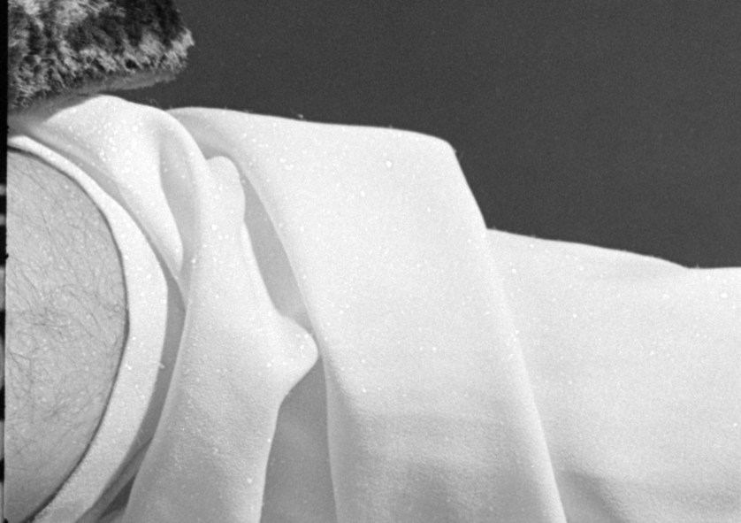

Hi, I ran into the problem I couldn't solve by myself. Recently I've bought Rollei Digibase C-41 chemistry and prepared my first batch. First 2 films were developed OK, but after that strange things happened. Earch roll has some strange residue on both sides which looks like a glue or syrup with tiny airbubbles trapped inside. This is visible only when looking at the film at angle. Scans are mostly quite OK.
But yesterday I've developed my very first XP2 Super roll and it was horrible. The syrup-like thing is more pronounced and it shows up on scans.
Below I'm attaching the example scan (@1800ppi)
The chemistry is not exhausted yet (it happened at 1/2 of declared capacity).
I've used demineralized water to prepare chemistry.
I used the chemistry to develop Kodak Portra and Fuji Superia films.
I will appreciate any tips or advices.
Janusz
P.S. I do my own E-6 and traditional B&W processing, and never had such problem before.

Last night I've developed another roll of Reala (120) in the same batch of chemistry.
I skipped the wash between CD and bleach, and I inspected the film after the final wash and before the stab bath.
The film was pristine.
Then I putted the film into the stab bath for 60 seconds (agitation by rotating the knob, not by inversion) and inspected the film again.
Bingo! The problem appeared again. So I washed the film in demineralized water with drying aid for 60 seconds, and the film looks almost clean now.
I have no idea what contaminated the stab bath. Maybe I should stick with one film manufacturer (no Kodak/Fuji/Ilford mixing)?
Is it safe to wash the film after the stab bath? Or should I repeat the stab bath using fresh chemistry?

There have been reports of gunky final rinse (stabilizer) in Rollei Digibase kit here before, so you are not first.
No film should contaminate the final rinse. I'd guess the problem is in Rollei kit, unless you have put something unwanted to the bath.
You shouldn't wash after final rinse, and therefore should repeat the final rinse using fresh and well-known chemistry, preferably from a major manufacturer if possible.

Thanks! I think that the problem is with the Rollei, too. I'm always using the same brand of demineralized water. Since I'm using good lab-grade bottles (Kartell PE bottles - one bottle for one kind of chemistry - I never reuse plastic bottle for something else), I do not suspect that the bottles are the source of the contamination.
JaZ99
Jan 6, 2009
68
I have prepared the new batch of chemistry (from the same concentrate). This time I used injection water (very pure distilled water) instead of demineralized one.
The problem vanished. Since the water is the only thing I have changed, I think the demineralized water was contaminated or not clean enough.

My problem is NOT a reticulation. I can wash it out :wink: And it is caused by the stab bath -- as I wrote before -- I inspected the films before and after stab bath.
I nailed down to water - everything else was the same. Same temperatures, same film batch numbers, same chemistry concentrates, same bottles. Only one thing was changed -- water used to make stab bath.
