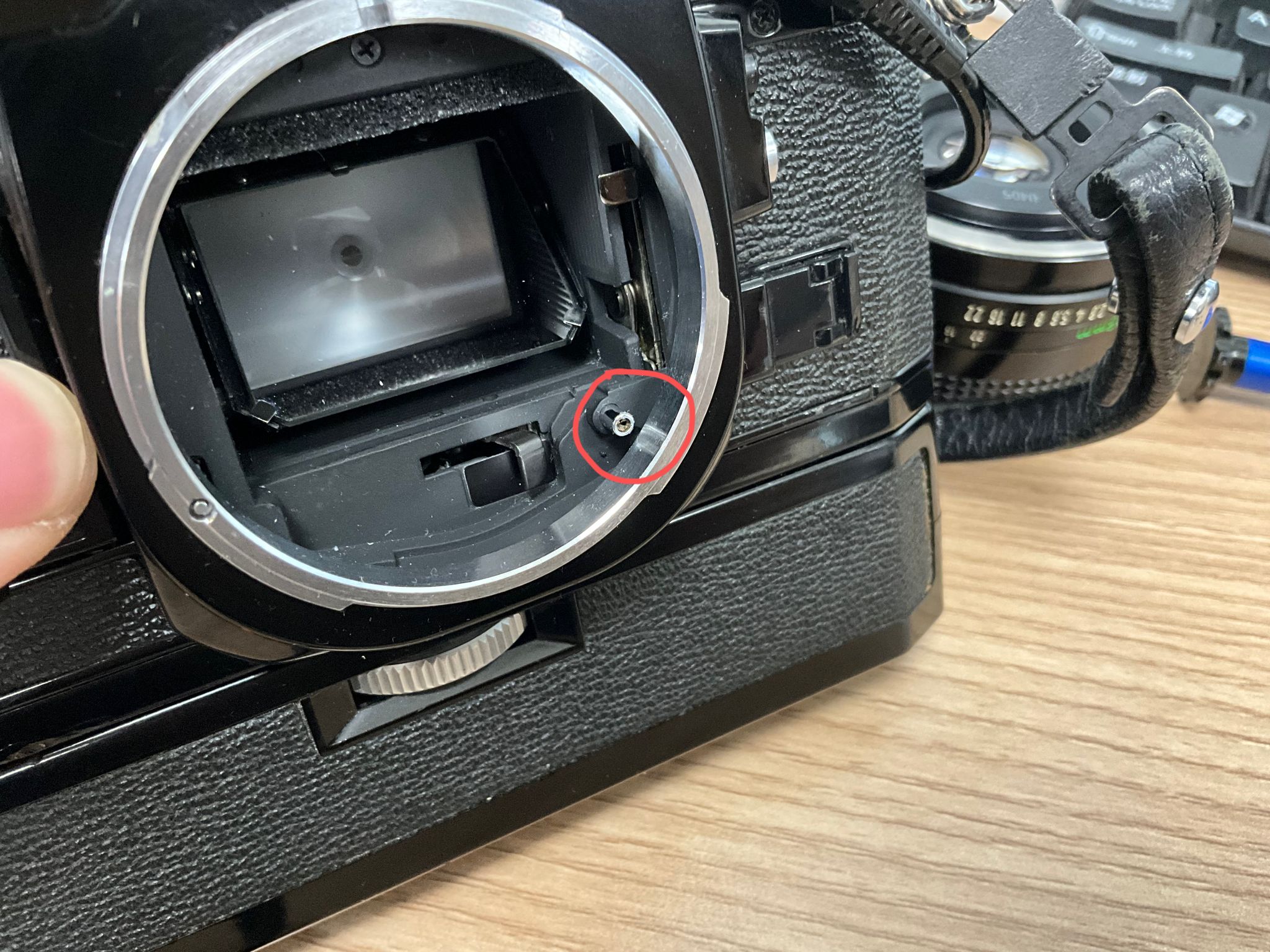

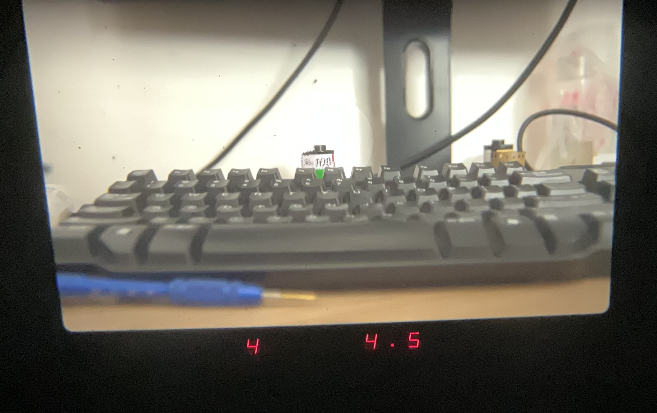

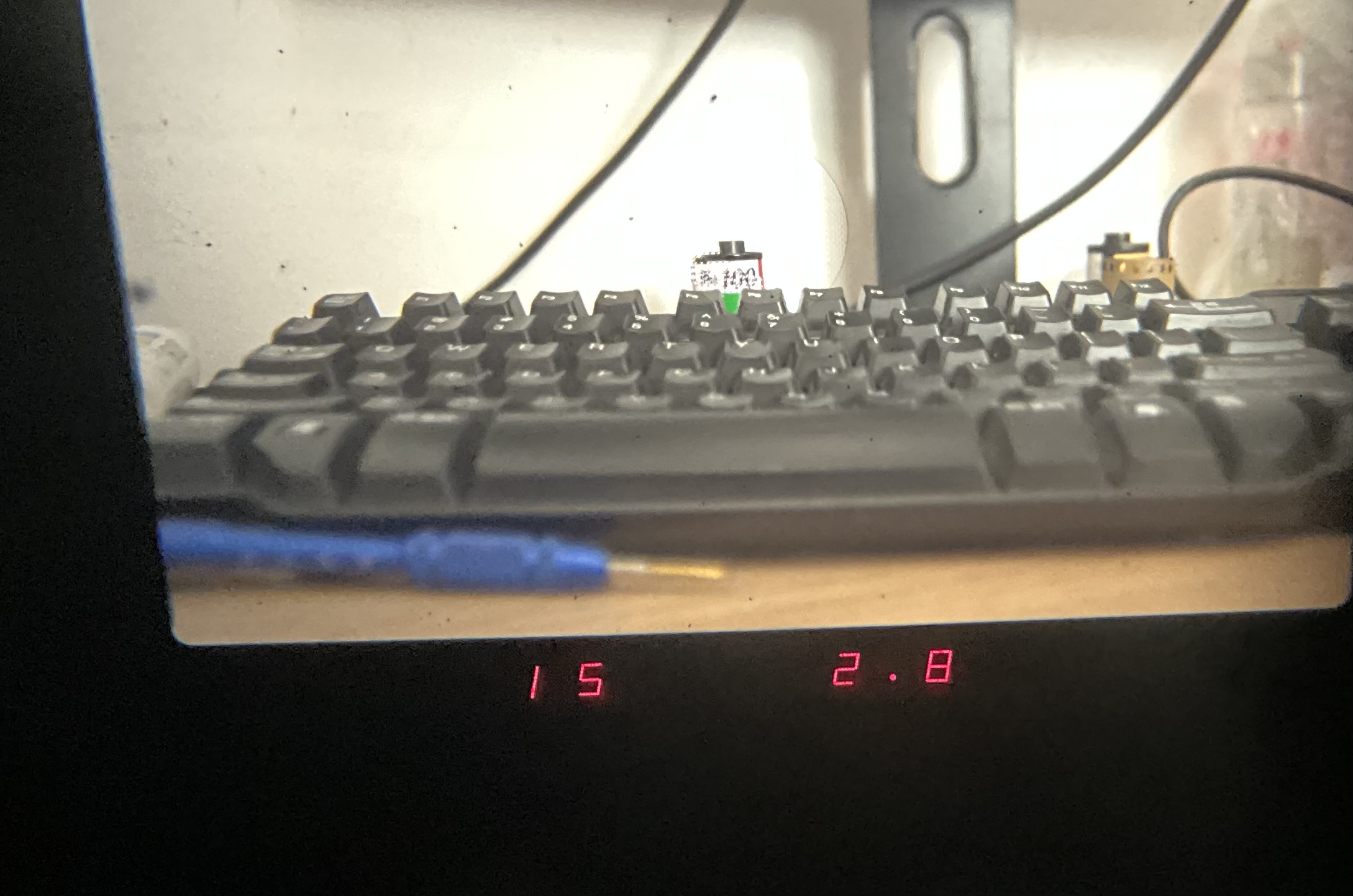

The same problem occurs when I attach the NFD 28mm F2.8 on my canon A1. When the lens aperture is set on A the aperture value controlled by the cam stuck at 9.5. I tried to clean the AE switch pin and the problem is solved. I hope this would be helpful solving your problem. IMG_1070.jpeg IMG_1071.jpeg IMG_1073.jpeg
