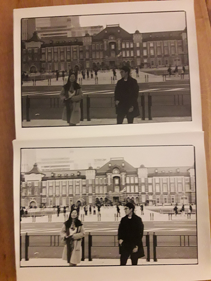

    It is hard to put this in words, but sometimes I get some prints that are somehow "mushy", they look kind of "dirty"... it looks like print does not snap, there is no pop out. I am not sure why, is it the light, wrong contrast grade while printing...
    It is something like example below - upper print has all details, but does not pop out, lower has pop effect, but with too high contrast, so the details are lost - and therefore not satisfactory. Should I use higher contrast while printing, but with dodging and burning get all the details in the highlights, so that I have increased local contrast - but overall uniform contrast with no blow up highlights, and no loss in the shadows?
    It happens to me sometimes, not often - and on the same negative some frames are perfect with for example grade 3, and some are suffering with this. I doubt it is the negative developing, could be bad lightning in the scene? Some frames are good only with dual (split) grade printing and with excessive burning and dodging?

    A mushy photograph is one of the hardest to print with contrast or "pop". Sometimes they can be saved with increasing the contrast, split grades, burning or dodging, bleach, ... , but generally a lot of work does not pan out to something worth the effort. I have avoided mushy photographs by using an incident meter [especially in snow scenes] or picking out the part that I want and making the exposure put it in the desired zone. HOWEVER when a mushy photograph does get printed will it is well worth the work.

    hi darko
    if you were to make a print JUST of the mushy part would you be able to do that ?
    if you can get that part the way you want it, dodge the upper part when you print the lower part ,,,
    and burn in the upper part as if you were printing it on its own.
    it takes a little practice but it comes naturally after a while.
    sometimes it is just dodging it a little but and burning in with a slightly higher contrast grade.
    good luck !

    Sorry thats garbage looking again.
    First one is too soft second one is too hard so cant you just find a grade inbetween ?

    I am using Focomat V35 with standard Focotar 40mm, Foma FB variable grade paper, Ilford PQ developer.
    First one is without grade filter (so grade 3 I suppose), second one 4, or 4 1/2. Film was Ilford Pan 400 in Rodinal 1+50, but they are non mushy frames on that film...

    Try putting in a grade 2 filter and reprinting it. I suspect no filtration is actually printing at grade 0 or 00 and that if you use a 2 or 3 filter you will see a substantially more contrasty print than using no filtration.

    Are you using fresh developer? Your paper doesn't look fogged.You look like you made the same prints twice. If you made the good one first, and have difficulty after subsequent prints, taking darkroom notes will greatly help with printing the same neg in the future.

    no, like with most VC papers the foma is grade 2 without filter.
    I would try 2.5 and 3 next...

    Using a #2 filter rather than printing with no filter makes it much easier to adjust contrast by changing filters - the exposures are much easier to match.
    Use the #2 filter and arrive at a print that gives you a pleasant near highlight rendition - say on the woman's coat.
    If the shadowed and dark areas don't appear dark and contrasty enough, adjust the filter up a half or full "grade" and print to match the tone on that coat, to see how those shadows and dark areas now appear.
    When those shadowed and dark areas and the coat appear the way you want them to, you may need to burn in highlights that are still too light and lacking detail, and dodge any dark areas that are too dark. Sometimes the burn may need to be at a softer contrast setting, but try it first at the same setting as the rest of the print.

    my enlarger prints around grade 0 without filtration no matter what Ilford say and it looks like OP has something similar to me - as that looks a lot more than 2 grades of contrast difference on my computer screen at least.

    [some points already made in posts above, some not]
    • big difference between the two "prints", maybe the goldilocks print is in-between

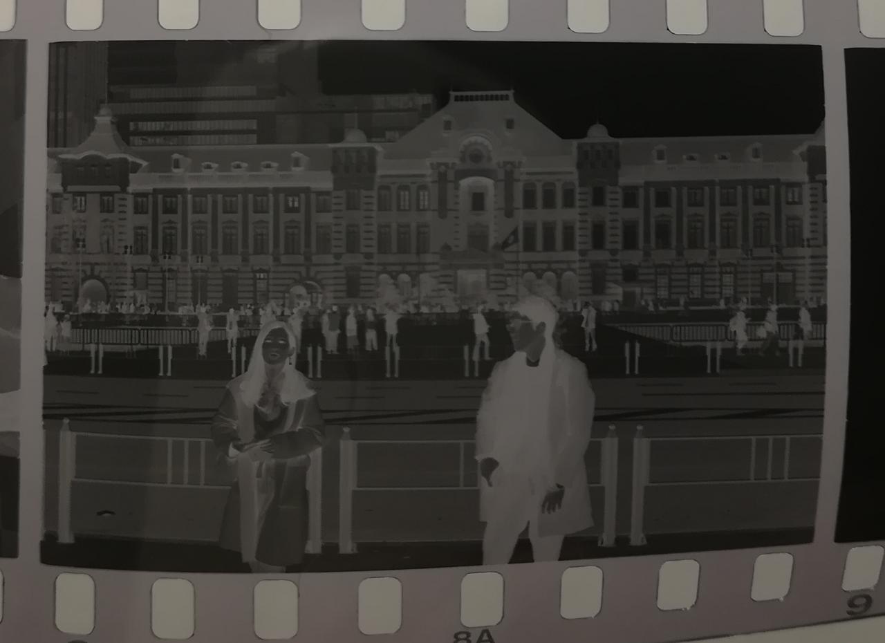

    • no details in dark parts (coat) in either of the prints: could the negative be underexposed?
    • on some days the light is just... shitty; what can you do with poor light?
    • could you show us a digiphone pic of the negative, e.g. against a white computer screen? A comment that applies to every similar post about "problem" prints.
    • could you the device that shall remain nameless here, and show us a histogram of the negative? I bet it is poorly populated; just (a) sky areas; (b) underexposed, compressed dark tones, with little in-between.

    A lot has been written already, but still a few things to add:
    * When you plan to develop in rodinal or one of it's clones it might be wise to overexpose by about 2/3 of a stop, as those developers have the habit of not achieving full film speed. This will give you better shadow detail, and make negatives easier to print.
    * When there is snow in the scene or when there is back lighting overexposure won't harm either. Metering the light with an external incident meter in general gives a better idea of the exposure in those situations, as Sirius already remarked. Also remember that when using negative film over exposure is hardly ever a problem, but underexposure might lead to loss in shadow detail. So when in doubt: overexpose.
    * Always use a filter in your enlarger, as it makes moving up and down half a grade way more easy, as MattKing also remarked.
    * Start with making a print where the general contrast and tone is about right. When you think grade 4 to contrasty, go to grade 3.5 or grade 3 and try again. When the overal grade and tone is good, use burning and dodging techniques to improve the print further.
    * In the example you show in the first post, i would make a new print based on the second, hard print, about half a grade softer and perhaps a bit darker and then check overal grade and tone again.
    * Next step would be to burn in the all corners about a third stop, so the image becomes a bit more focussed. Third step would be to fill in the right upper corner with part of the building using a grade 5 filter, so the building is about the same tone everywhere.You will also have to decide how grey the sky needs to be: noticably grey or just off white.
    * One of my favourite dodging tools is an old grade 5 filter, cut up to a circle of about 2cm. I would use that to hold back te dark coat of the man, about half a stop as a first try. What a grade 5 as a dodging tool does, is to increase contrast locally, improving tonal seperation. When done right it will add just that bit of shadow detail in the dark coat, without making it look grey and muddy.
    Making good prints is a lot of work and difficult negatives take a lot of try and error and use a lot of paper, but that is the way it is.

    I see that in this example I used trix, not pan400, not underexposed npr underdeveloped. But the question was more in general, not only for this photo.

    Most printing problems of this type are from under-exposed negatives as you have demonstrated.
    There is no detail in the man's jacket, so your print will either show his jacket as gray (top) or all black with no detail (bottom).
    You can't print what is not on the negative.
    Try giving an extra stop of negative exposure on your next roll. I usually tell students that if the ISO is 400, set the meter to 200.

    The way I work with 35mm is make the first "test" print using a No.3 filter or No. 3 contrast paper. It is my understanding that, using MC papers, no filter is somewhere near a No. 2 paper. Try printing the negative again with a 3 filter. The photograph also has a "bald" sky which experience has taught me to almost always "burn-in" the sky. Snow is very unusual where I live but white sand is not and an overcast sky can make both look "grey" in a B&W and must be compensated for........Regards!

    "It happens to me sometimes, not often - and on the same negative some frames are perfect with for example grade 3, and some are suffering with this. I doubt it is the negative developing, could be bad lightning in the scene? Some frames are good only with dual (split) grade printing and with excessive burning and dodging?"
    The bottom print is certainly a good starting point that you could improve with some dodging and burning. However, the core problem is what you wrote yourself - that the scene has very flat lighting. With such lighting you are never going to achieve more than an OK looking print.

    Excellent prints have been made of subjects with limited scene brightness range. In fact, negatives with very large density range can be the most difficult to print.

    That negative looks fogged to me. Are you sure no light reached the film in between camera exposure and film fixation?

    Negative is not fogged, ot is just crappy photo from mobile phone.

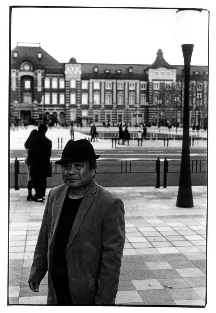

    Here is another example from same negative on same paper - where result is satisfactory to my eyes - even with high contrast, no shadows in dark areas - I see pop effect, it is not mushy..
