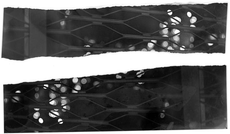

I mean gray and mushy. Attached is two test strips I did a little while ago. I guess I shouldn't, but I'm comparing these to negative scans, which came out a lot better.
The funny blotches I'm guessing are from irregular development and/or contamination, but the image in general is lacking in contrast. The upper test strip has good highlight detail but grayish blacks. The lower test strip has good (better) blacks, but the highlights don't seem to pop as much.
It seems to be a fine balance when printing these shots. But then again, I'm still a beginner.

By "highlights" are you meaning the latice work, because they cannot be judged highlight, more of a dark mid tone in which case you will find it almost impossible to get the seperation I think you might be after from the black background. The only other true highlights are the specular ones which will have very little, if any, tone. I think you could be after something unattainable in this neg. and need to experiment with producing a wider contrast range (which is difficult for night time) using the suggested development techniques.

No, I mean the pinpoint lights in the background. I don't want them brilliantly white, but a little more "punch" overall would be nice. I think I'm comparing my prints to negative scans, which is perhaps unfair?

If you don't want the pinpoint lights brilliantly white, consider flashing them locally with a dimmed pen light (I use partially flashed film leaders as small ND filters for this purpose) , with the neg still projecting through a red filter guide you where to flash. The points of light will otherwise when printed as grey a bit leave the rest of the print as blah. If the surronding area is almost full black, then a bit more from the flashlight overspill won't make much difference.
The other possibility is to make an (usally unsharp works best for me) contrast reduction mask to cut the contrast range of the too high contrast neg, when the original neg and reduction mask are projected in registration. Hoer the use of an USM and sprilt filter burning may still be required.
