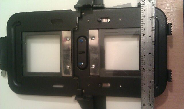

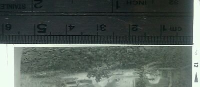

My Opemus 6 glass carrier is 54x54mm. Is that the right size for my MF 120 negative frames which are 57x56mm ? I was hoping the carrier wouldn't crop the negs but it does.
Any thoughts?

I use a meopta 6 enlarger, and my negative carrier uses interchangeable inserts for the various formats, 35mm, 645 and 6x6, the largest size that you can print with this enlarger,Not sure were you are but RK photographic in the U.K still have some spares, http://thedarkroom.co.uk is the site, if you have problems it is possible to make the right size out of mounting board, it is fiddly but it works, I have done it myself.

Gandolfi, thank you for the generous offer ! my main concern is that i already have the 6x6 carrier and 54mm is the actual width of the frame cutout on all of them. can you or somebody else measure the cut out size for me? if that is the largest sold then when you see the pic in my last post i will be losing 3mm from my neg frame.
