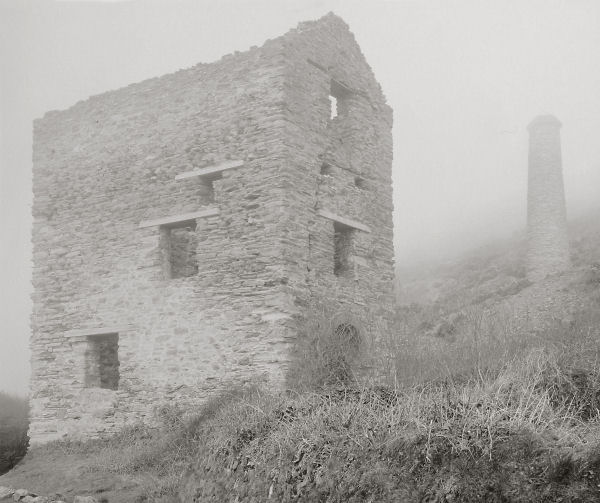

I've shot a lot of images in mist and quite heavy fog. I totally agree about the contrast, don't increase negative contrast with development and the same when printing.

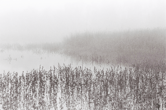

Both taken in quite heavy sea mist or fog, the films sees more than we do.

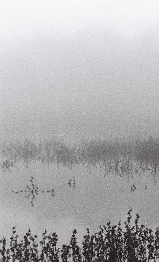

Here's a sample of what I'm talking about. This is a fuji scan without further edits:

In some ways the 2 images I posted are the exact opposite, the first is a 10x8 negative, the 2nd 5x4. But then there's more than one approach, it's just finding the right balance.

I am kind of surprised that this is seen as a low contrast image. It has white up in the sky and it has black in the weeds and plenty of midrange tones. I think choosing a paper that will distinguish all those midrange tones is the difficult part, but there are more than six tones (zones) here.

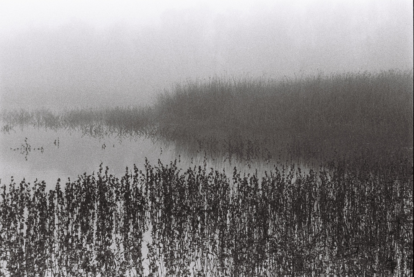

No, this rendition of the scene has that contrast range. Ultimately it's an arbitrary choice how the image is projected onto the tonal range of the output medium. What I said earlier is that there might be a tendency to decide by default that the image needs to occupy the entire tonal range, but for misty scenes like this one, I personally don't think it necessarily works well to have heavy tones dominate the scene. E.g., it might just as well be interpreted along these lines:
There's no objective truth here; it's a matter of preference and interpretation. And the tonal scale of the output image (print or digital file) is not in some way embedded in the negative. It never is!
In the specific interpretation you were shown in post #6, there might be. But that's not objective, universal truth.
Printing isn't a positivist activity. It's constructivist by default. Otherwise we wouldn't have to worry about different papers, grades, developers etc. We would have just one system with a hardcoded transfer function between luminous range of the original scene to density or tonal range in the output.
