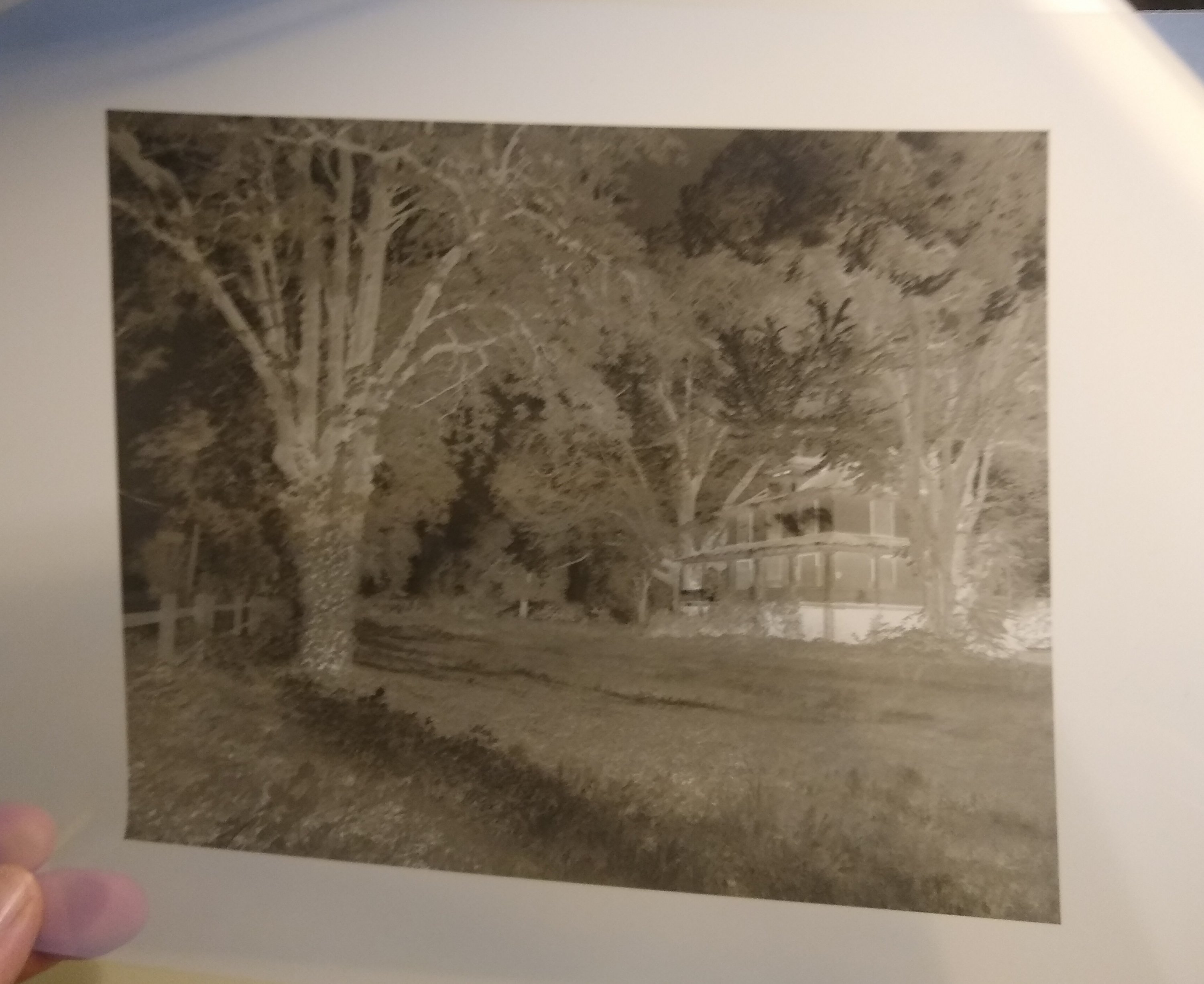

Here's a negative printed on that film from the screen print store... Just made a print, too. This stuff is the very same in looks and characteristics. I won't have to make any adjustments, to accommodate it. Thanks again for pointing this shop out to me. I chatted with the owner. He's been there for 18 years! I had no idea! The reason why his stuff is cheaper is because everyone pays one price. Willox has a cheaper wholesale price and a higher price for the average Joe. I know where I'll be getting my films from now on!
Beginners luck!
Now that I have your ear...what kind of UV light source do you have? Do you expose your prints by a set time on the clock and if so, do the exposures vary for any reason? By inspection? Or do you use a UV light measurement device? (Have my eye on a measuring device, but it'll chew through a good portion of my budget).
I use a BLB exposure table, designed for screen printing. I also use a plate burner, also used in the screen printing industry. That one is used for carbon transfer. I have a set time, depending on process. Exposures are always consistent. I've never used a UV measuring device.
