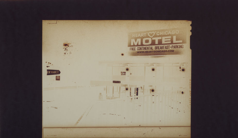

Here's the first one I did. It happens to be a slide that I POP'ed, but what the hay, i like it!
This was done a couple weeks ago and by now the "white" is maybe just a couple zones removed from the darkest bits.
And for what it's wroth, to deviate from theory and science for a bit, a little background... This is the Heart O' Chicago Motel in none other than Chicago. I stayed there with my girlfriend, expecting a cheap, clean and retro motel. It was all three things, but could've used a bit more cheap. Good management, but when you show up at 2 in the morning you might be told to double-park somebody. Don't worry though, if that person needs to get out before you they'll just call you in the morning..

It bleaches a lot in fixer, becoming a nice brown color. Expose it longer, and you can get a beautiful dark brown.
