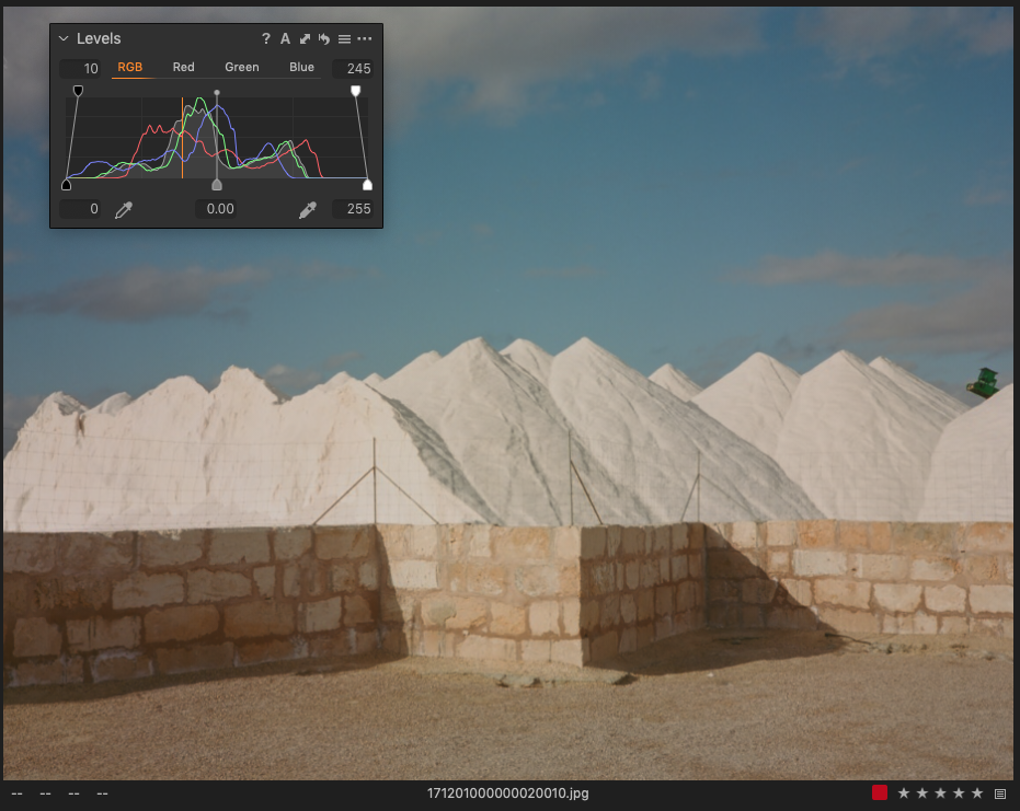

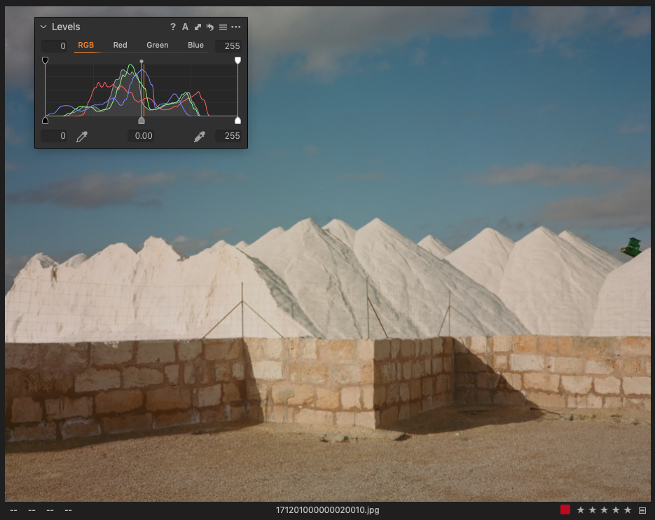

Digitally wouldn't be a problem, pull in the shadows and highlights. I'd use levels, but I'm sure curves would be much the same.
I will certainly look into the bleach bypass, but on first glance it seems much too extreme. I'm after a subtle change.
I guess it's a slight overall lessening of contrast, but hopefully without affecting the mid-tones too much.

What you describe is simply lower contrast. You'd have to either increase exposure and pull develop your negatives, or you could play with a mixture of RA-4 CD and regular B&W developer during printing.
