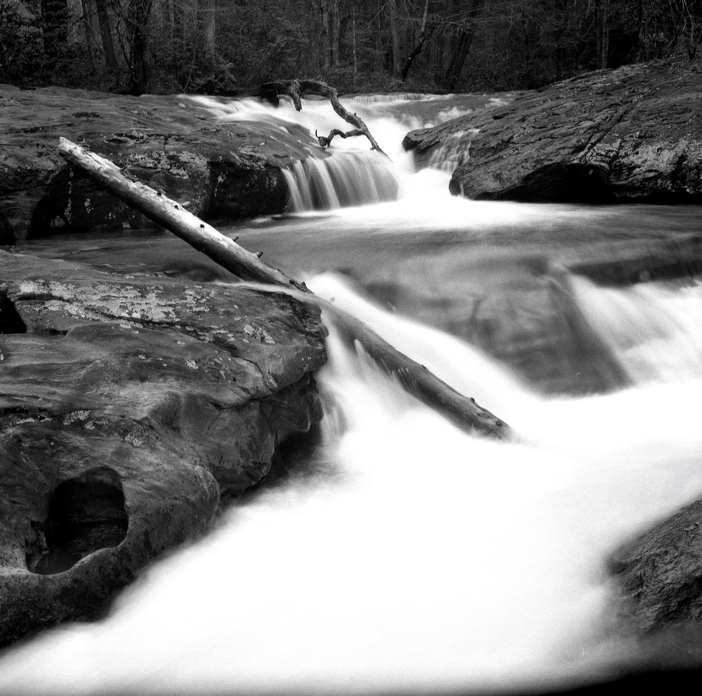

I am curious to see the different effects various shutter speeds have on moving water: oceans, rivers, waterfalls, etc. I am especially curious about ocean water - the look is harder for me to nail down since the waves move more slowly.
Of course, water moves at different speeds. What've you got?

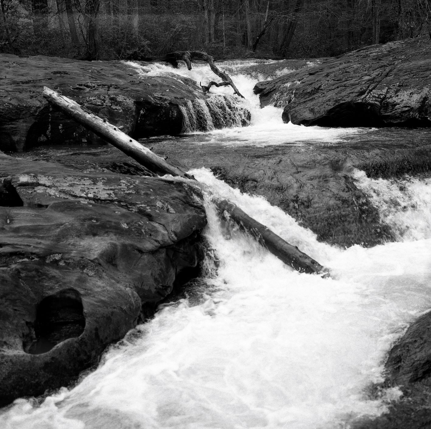

For me, the first was 1/100 (I think), the second was 2 seconds. These are unedited, and I realize one has a light leak:

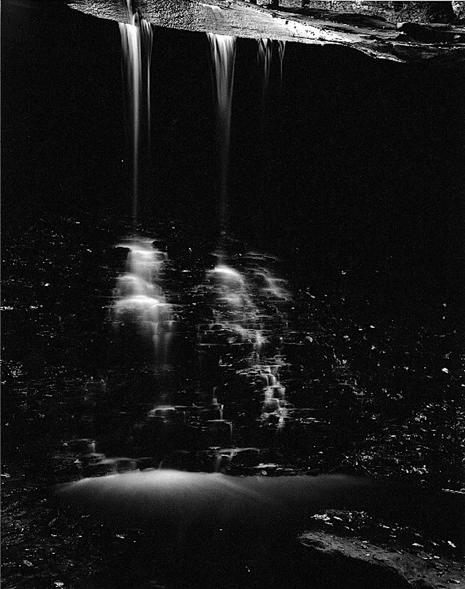

4x5" shot on Delta 100
f/40, 73 seconds exposure (metered at 30s, but there's reciprocity failure to deal with)

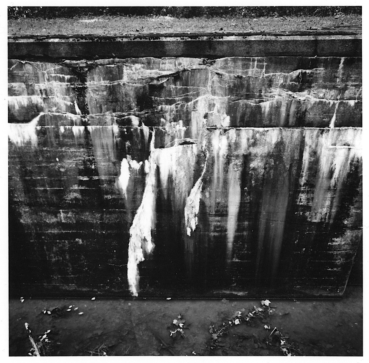

I sometimes include these next two with my 'water' images. They are NOT moving water.

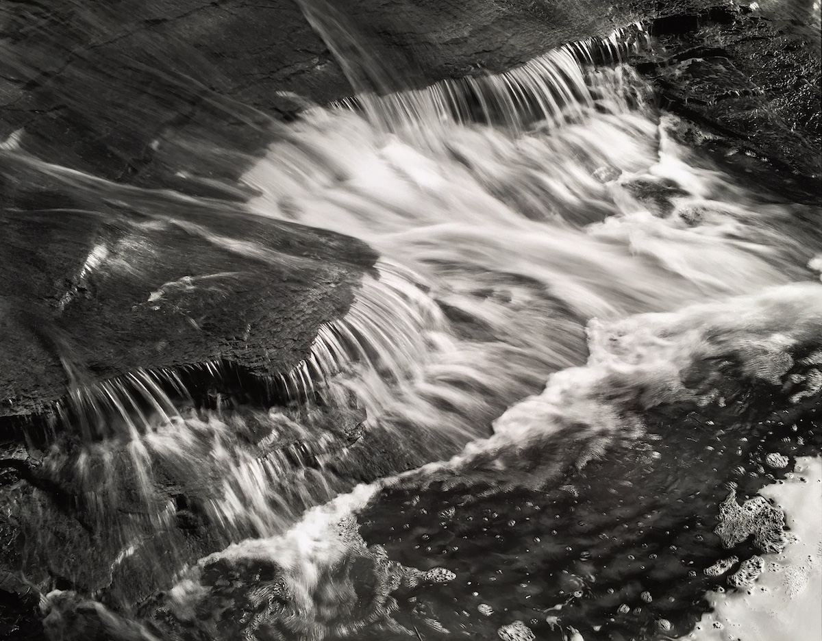

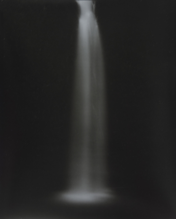

1 second f45 Polaroid E6 (Fujichrome 100D)

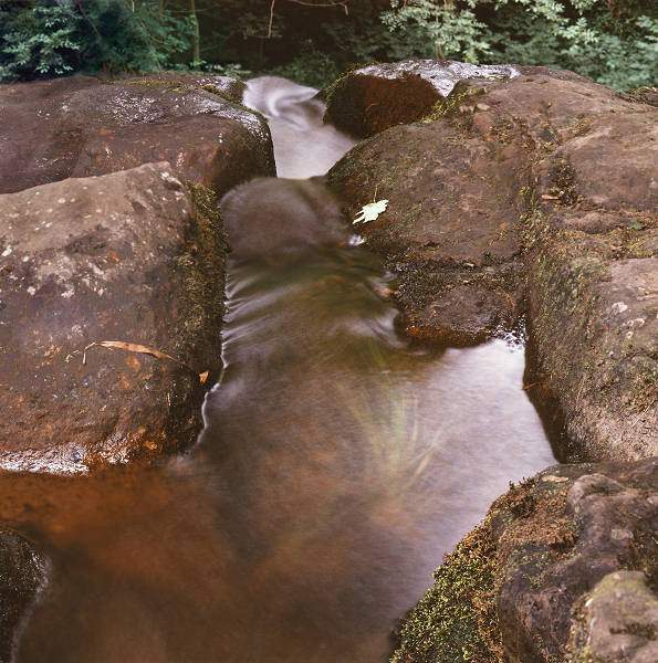

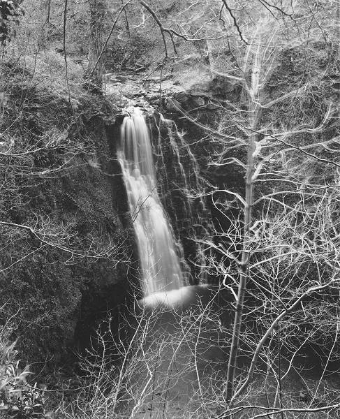

6 second f64 Fortepan 200, same waterfall Falling Fosse at Midge Hall (Nth York Moors) a few years apart.

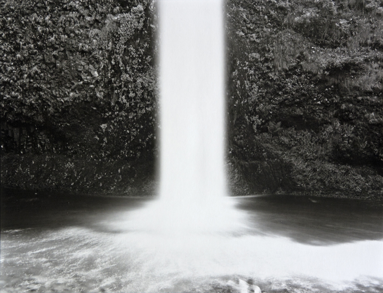

Two 11x14 images of Horsetail Falls, OR.

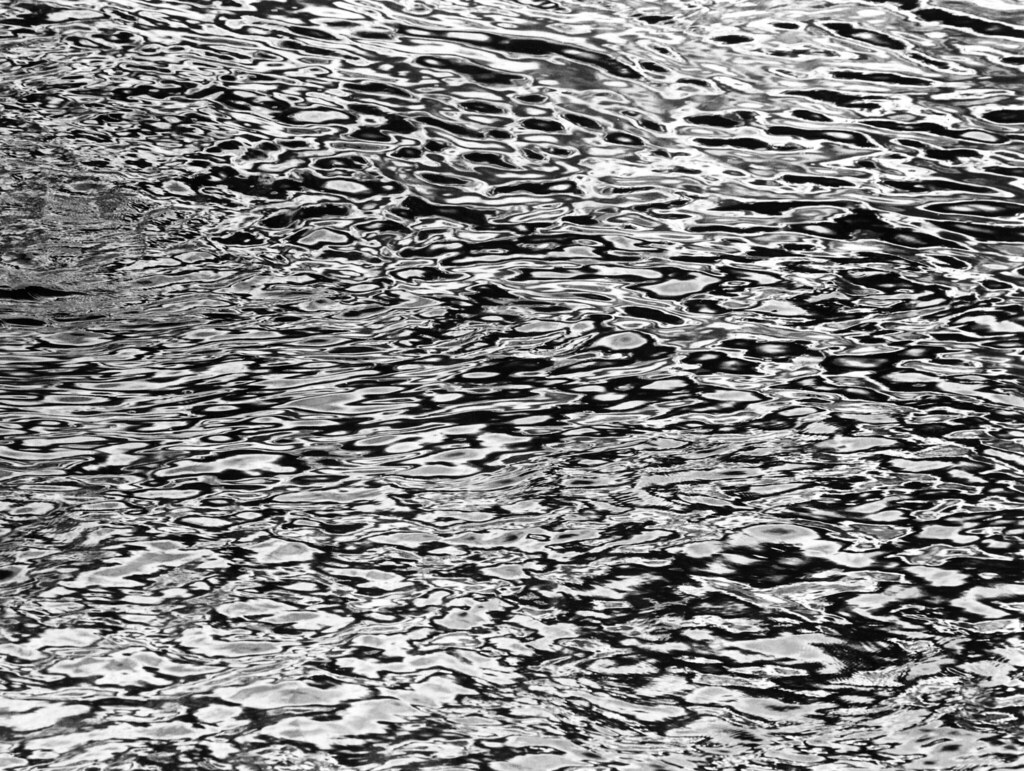

Ripples, Noosa River.
Gelatin-silver photograph on Agfa VC FB photographic paper, 16.3cm X 21.5cm, from a Kodak Tmax 400 negative exposed in a Mamiya RB67 with a 360mm f6.3 lens. Shutter speed 1/250 sec.
