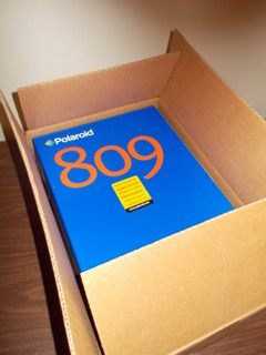

8x10 Format
Yes they are, if you planned ahead.
My Precious! 😍
When B&H photo received their last shipment from polaroid I stocked up.🙂
