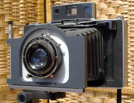

    It doesn't answer your actual question but I did this to mine:
    Steve.

    That's the sort of thing :smile: What focal length lens did you use - something closer to the 'stock' 114mm??

    I think it's a 105mm lens.
    I have a CNC drill/router at work which we used to use for PCB manufacture. We don't make PCBs any more but the machine gets used for making test jigs, assembly jigs,....... and camera parts!
    It's just a piece of 9mm thick grey nylon cut to shape to fit in place of the plastic moulding originally fitted. Behind the large hole is a thinner plate about 1.6mm thick which the lens is mounted in.
    With the lens fitted as shown, it can be focused in two ways. 1. Set the lens cell to focus at infinity and use the Polaroid focussing bar. 2. Set the Polaroid bar at infinity and use the scale focus on the front cell.
    The rangefinder was quite accurate despite not being for quite the same focal length.
    Steve.

    How did you afix the CNC manufactured plate to the body? Epoxy? Was the thickness of the plate a function of the proper distance between the optical center and point of focus at the film plane?

    The plate has a vertical hole through one end, hand drilled hence that end being split into two pieces. It would have been impossible to drill all the way through in one operation, and a couple of screws from the bottom plate up into my nylon plate.
    The vertical bar of the frame on the left goes all the way down to the bottom plate and through the CNC cut piece.
    This is the way the Polaroid moulding is mounted so I just copied that. Note that I totally removed the Polaroid front and replaced it with my own. The bellows are mounted on the back of the lens and held in place with the lens retaining ring. I think I made another plate to sit inside the end of the bellows.
    The thin plate behind the main plate allowed me to use various thicknesses of spacer until I got the lens in the right place. Ideally, I wanted the lens right on the front of the grey plate but it was too far forward so I used the second plate to recess it.
    I have a scrap pack film holder with a piece of frosted polyester fitted to allow me to check the focus and adjust the lens shim. All by trial and error (mainly error).
    Steve.
