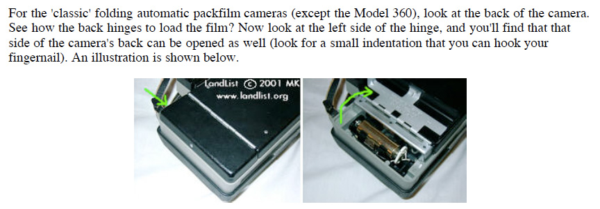

    Finding out more...
    See attachment.

    The battery compartment is on the back on the opposite side of the film door (shares the hinge.) Just pull gently on the door near the silver button. While the original battery was 4.5v, people have found that 3v is sufficient to drive the shutter. I use a CR123A lithium battery with a spring to make up the length difference. You can also find instructions on other custom battery adapters via google. You can verify proper shutter operation by dry firing while looking through the back.

    The Polaroid 100 camera has an automatic Electronic shutter that needs a battery. As you are holding the camera, your left hand is around the battery compartment. Pull the front of the camera back and the battery will be exposed.
