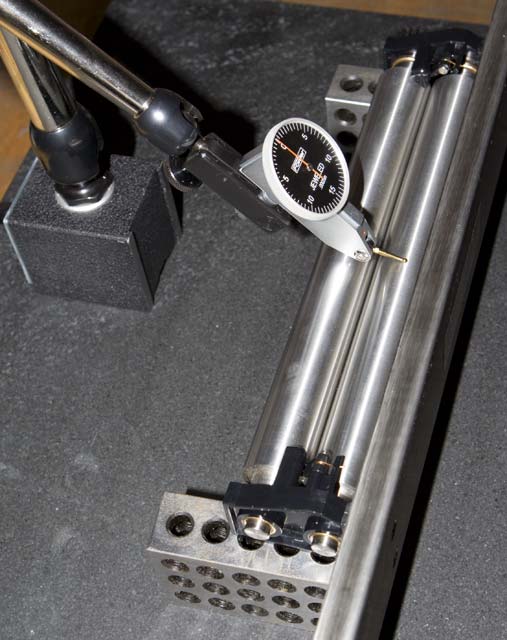

Another good idea. I pulled out some tools and measure runout. None. DNA. Dead-Accurate. I took measurements at four different places on each roller. They're off about .004" front to back as they sit in the processor, but I doubt that's going to cause a problem.
I wonder if I'm not cleaning them right. I took a paper towel and alcohol and wiped them. Is there a better way? Napha?

Cleaning the rollers is indeed very important with any Polaroid system, but a soft cloth and water should be enough, so if you still have a problem I don't think that it's the cleaning that is insufficient...
I second the "get in touch with Polaroid tech support" proposition above...
