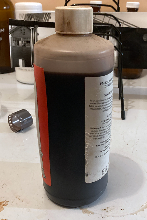

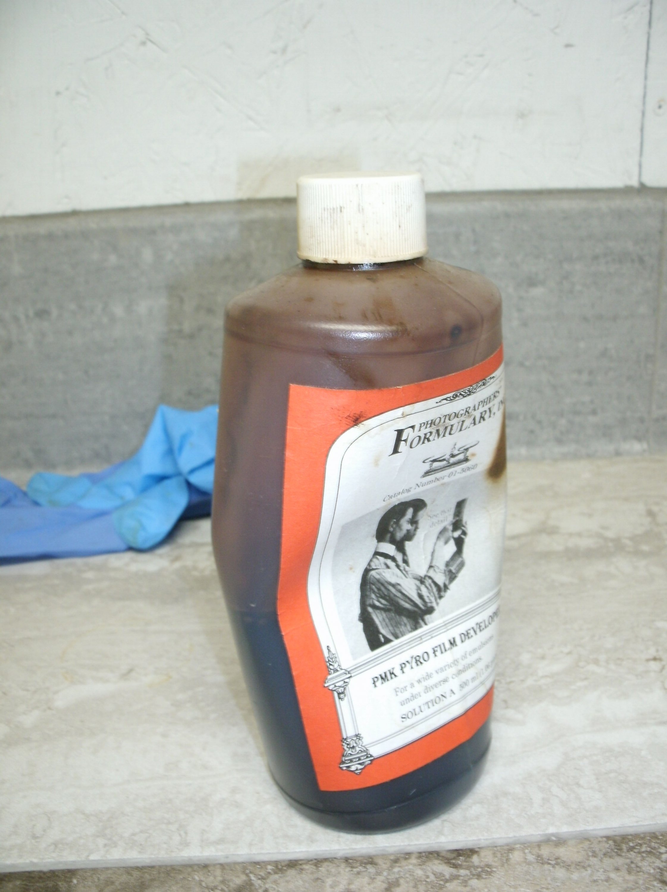

I've read many times how long PMK keeps in a bottle. This bottle is about 5 years old, it is quite dark, is it worth risking a film or should I toss it? Also, Part B seems to have a crystallised blob inside it which I suppose I could crush.

Yeah, I have some that old that looks just as bad, but it still works the same as it used to. Just shake the whoopies outta part B before you use it.

In contrast to Rick A's advice, I'd toss the developer. Too bad it's so full, though.
However, the pyrogallol component of the developer is likely oxidized to the point of inactivity (hence the dark brown color). Even if the Metol in the developer is still active, it will not have the characteristics of PMK when fresh.

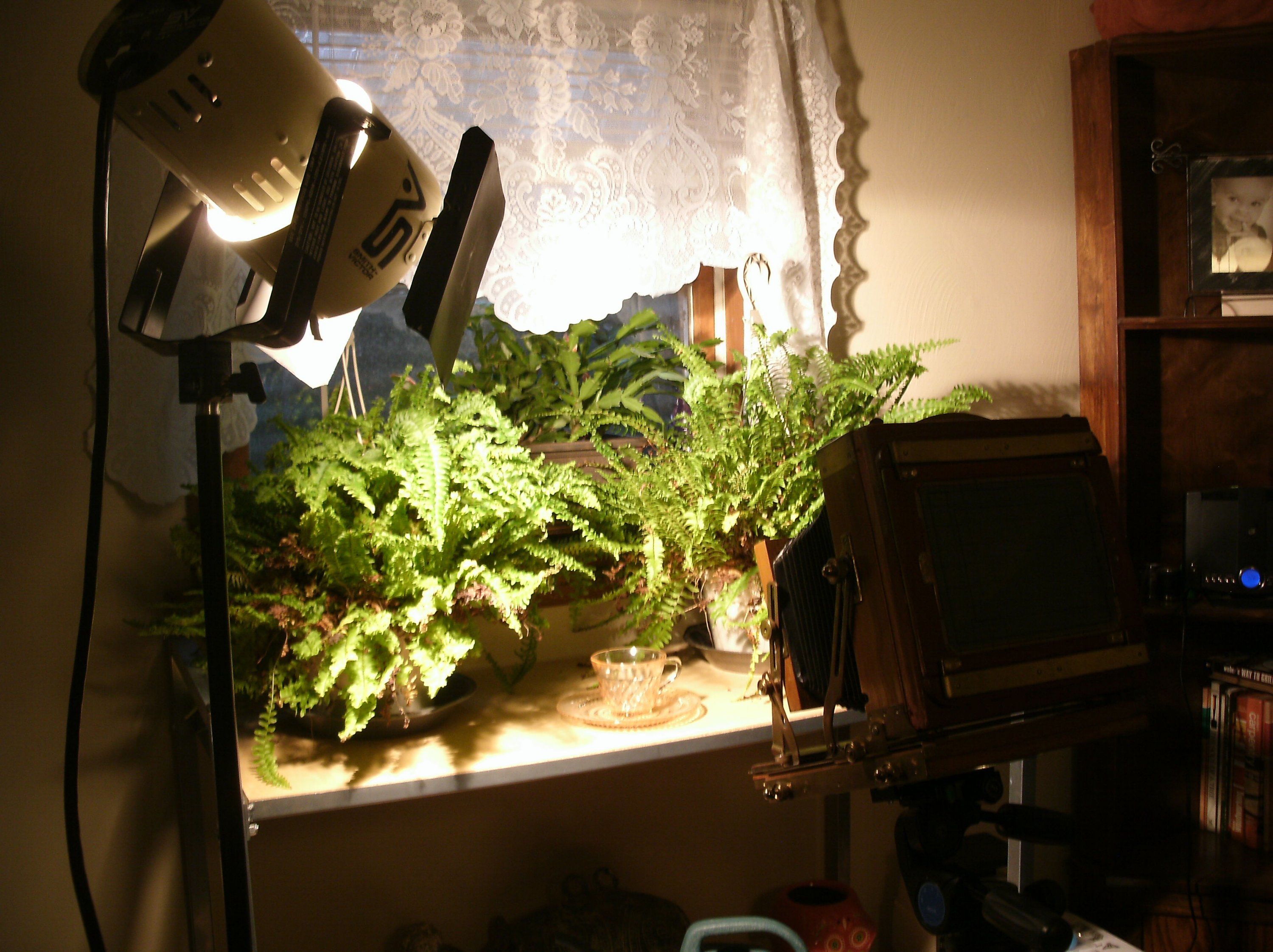

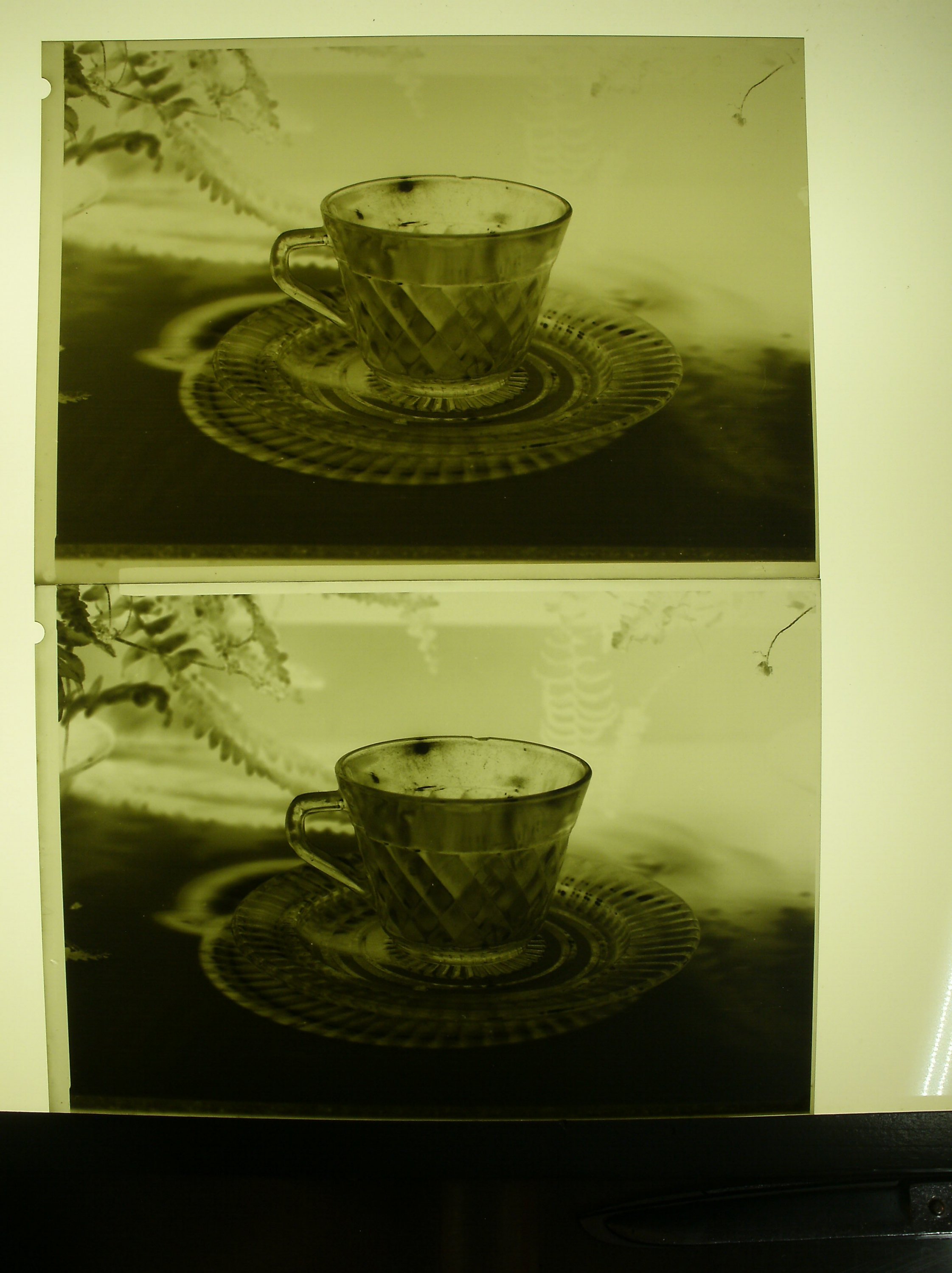

Looking back at my records, this bottle is just over 6 years old. I'm going to test it tomorrow and see if it still works as it should. I think that the stain may be diminished or non existent, but it should develop an image. Last used about three months ago and it still worked decently, but upon reviewing the negatives the stain isn't quite as prominent as previous rolls.
Rick A
Mar 31, 2009
9,925
Laurel Highlands
8x10 Format
Here are the results of my test, 6 year old PMK vs fresh. Negative on top was processed with the 6 year old PMK, bottom negative with fresh. The only difference between them is one extra stop of exposure for the bottom negative. Both were processed using rotary 10 minutes at 70f, shot with identical setup, using EDU Ultra 200 film exposed at iso 100 with my 5x7 camera with a Kodak Aastigmat f 4.5/6 1/2" lens first shot was one second at f22, second shot two seconds at f 22. Minimal difference in stain, no difference in image development that my old eyes can detect.
View attachment 299024 View attachment 299025
Which goes to show what Per Volquartz taught me: Pyro lasts damned near forever. Ignore the color it turns.
