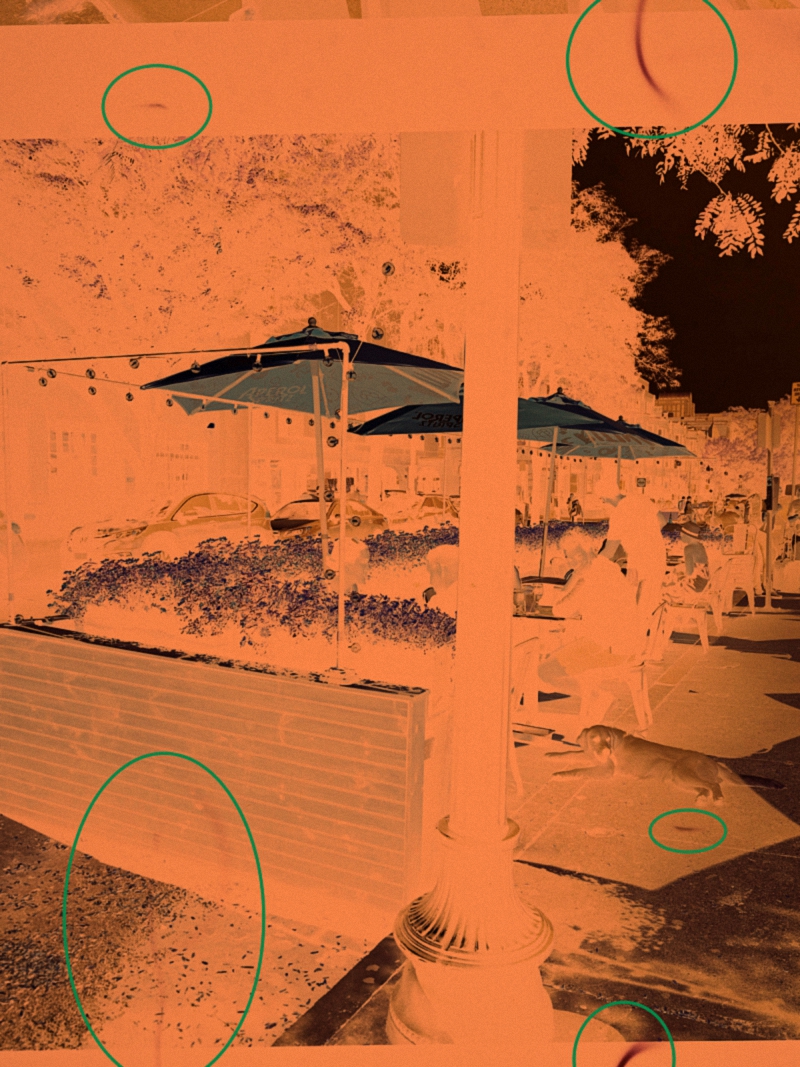

Every so often I get a green flare on a photo with this lens. Always this shape. Recently got a lens hood but it doesn't seem to matter. Sometimes even when I'm shooting with sun to my back. Not always but sometimes.
But this is really weird: the flare outside the photo. This is Portra 400 @200 in Cinestill c-41. Thanks for insight!

Is it flare, or a bend that occurred in the film when loading it onto your developing reel? that's what it looks like to me, a small crescent moon shape.
I've had that happen at times with b&w film, if the film doesn't advance smoothly into the reel.

I think you have more than bent film here. There are several other areas of what looks like light exposure. Do you wear a smartwatch that uses green LEDs for heart rate monitoring?
Edit: Looks like there is even more fogging to the right of the top crescent shape.

Just a quick observation on the 'crease leaks- they appear to be mirroring themselves. The larger upper right crease is mirrored and dimmer in the lower left. The upper left crease is mirrored and dimmer at the lower right.
(the lower right crease just entering the frame appears to be part of a crease like the large upper right crease)
I wonder if this 4-part pattern is the standard for any time the leak appears?
My gut reaction is that this is a back issue, not a lens issue. Put the film back in the camera as shot and see if the leak locations point you to anything. Be sure to look at the take-up nd feed chambers, not just the front-facing image area.

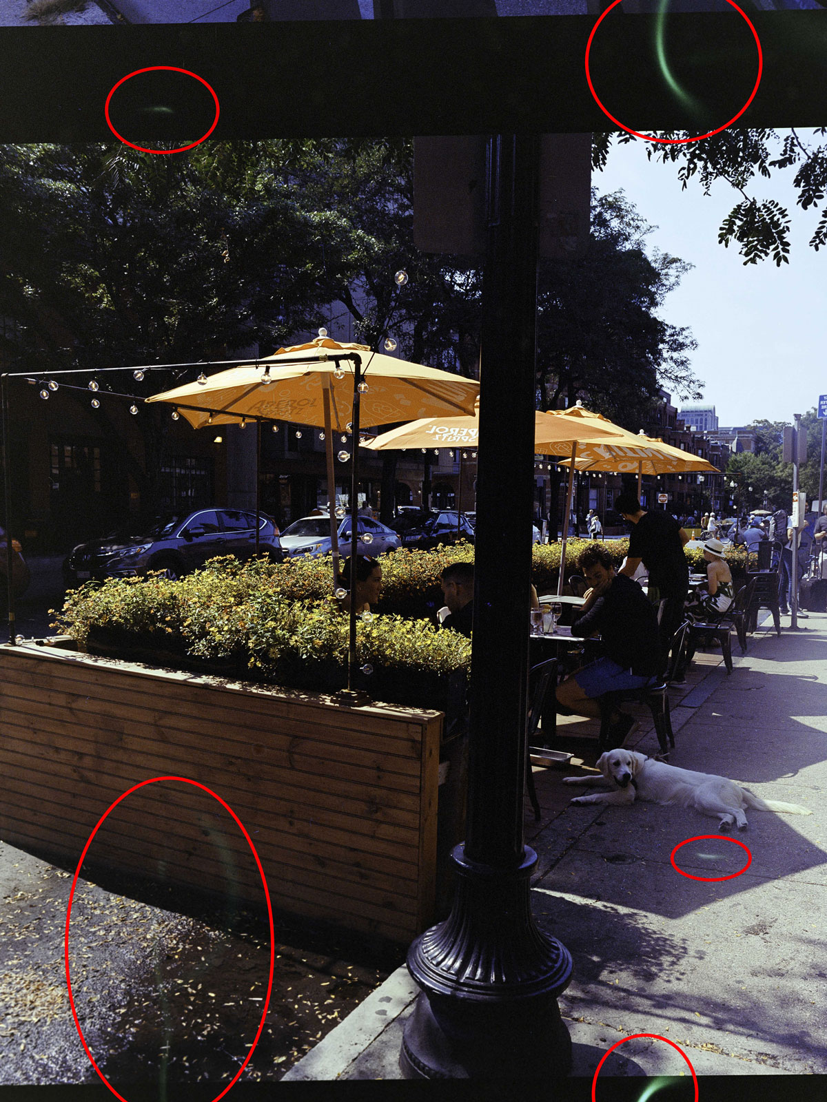

I checked the negatives and they doesn't seem crinkled.
But I DO wear an Apple Watch! (but not when developing film)
I am wondering, as Dan Daniel suggested, whether it's a back issue. Though I've shot several rolls through that back, and it's only been since I started using the 50mm, about 10 rolls ago, that I've noticed anything at all.

I also think this looks like crescent marks caused by kinking the film during loading. After this happens, the film does not necessarily have a visible crinkle. It is possible for the film to have been kinked on both edges at the same place.
I don't really understand what I'm seeing in the top of the original photo. It looks like the green mark continues into the next image area at the top. Are we looking at two strips of negatives lying next to each other? Can you take a picture that shows just one strip and shows the entire rebate to the edges of the film? It's really hard to figure these things out from cropped and overlapped images of the film.

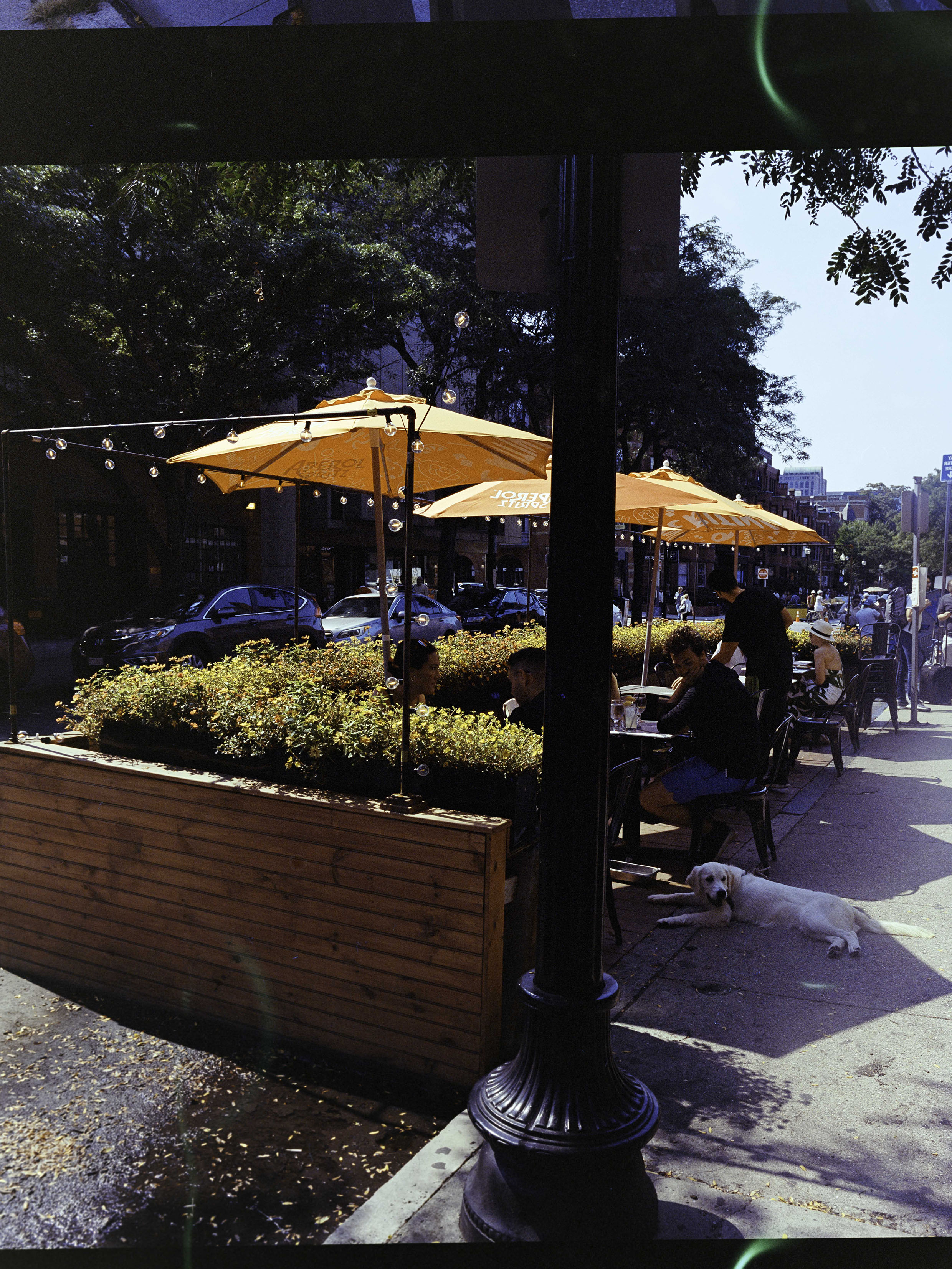

The artefact also appearing between frames already excludes the lens as the cause.

And that builds to the story that something kinky is going on with the film [pun heavily intended] so look at the film handling loading and unloading the camera as well as putting on the development reels.

Thanks all. I'll try to work on the film within the camera when I get a chance. But I do believe there was a little problem getting that roll into the film. It looks unkinked now, but it doesn't mean that it didn't cause damage when I first tried to get it on the reel.

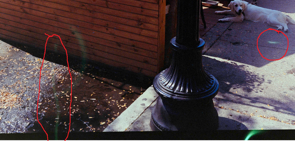

The small mark circled on the right looks like it could be a kink, but it would be a weird one. The meandering line on the left, however, really looks like a light leak.

I think that mechanical damage to an emulsion can lead to chemical changes that don't depend on light and its color. So you have crimps, like the crescents. And maybe the wavering line is from a finger nail dragging across or such?

It's C41 film with the orange mask it'll be more like this:
Looked at like this it seems someone struggled to load the film into a spiral and probably got into a mess. It's worth adding that there are a growing number of smaller outlets processing films, often in small processors.
So mechanical stress kinks, the bottom left is possibly where the film has dragged on the spiral at some point, or a loose end of the roll..
