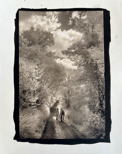

I haven't done many, but this is one of mine, "near Hartley Vale Road":
I find the tone is quite neutral... somewhat warmer than Clerc's, but not overly so.
The results will be affected by the usual processing variables, so you might be able to tweak the colour somewhat.
I am not able to access the link in your post. Any chance you might post the image directly here?
