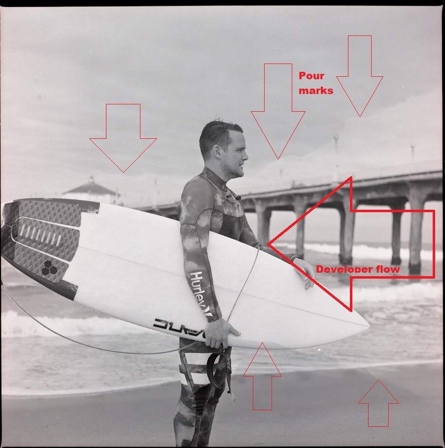

  21. bvy
    bvy Subscriber
    Messages:
    3,214
    Joined:
    Jul 22, 2009
    Location:
    Pittsburgh
    Shooter:
    The downside of tilting... Pour marks.
    Granted, this is C-41, so times are fast at just over three minutes. But it's something anyone doing C-41 in steel tanks should know about. This is what inspired me to look for a funnel to fit a steel tank.
  22. Sirius Glass
    Sirius Glass Subscriber
    Messages:
    27,027
    Joined:
    Jan 18, 2007
    Location:
    Southern California
    Shooter:
    Groups:
    That is a shame. It looks like you were on a trip to southern California. Kodak always recommended never using developing times less than five minutes for black & white. That as you stated in not possible for color work. I have not had those problems with the Jobo processor. I know that the processor and tanks can be pricey but one can not put a price on consistent reliable results.
