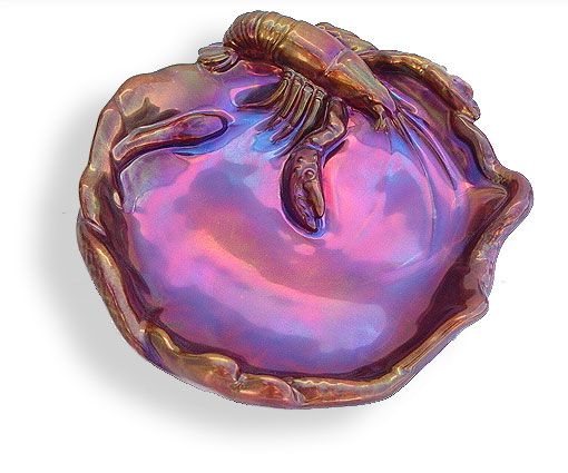

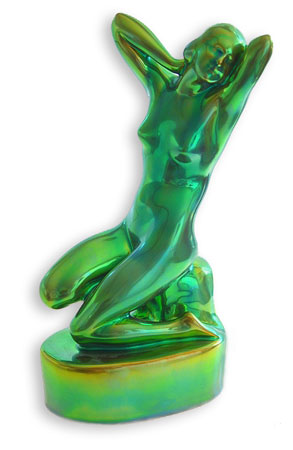

    Zsolnay Silver Copper Nanoparticle Colors

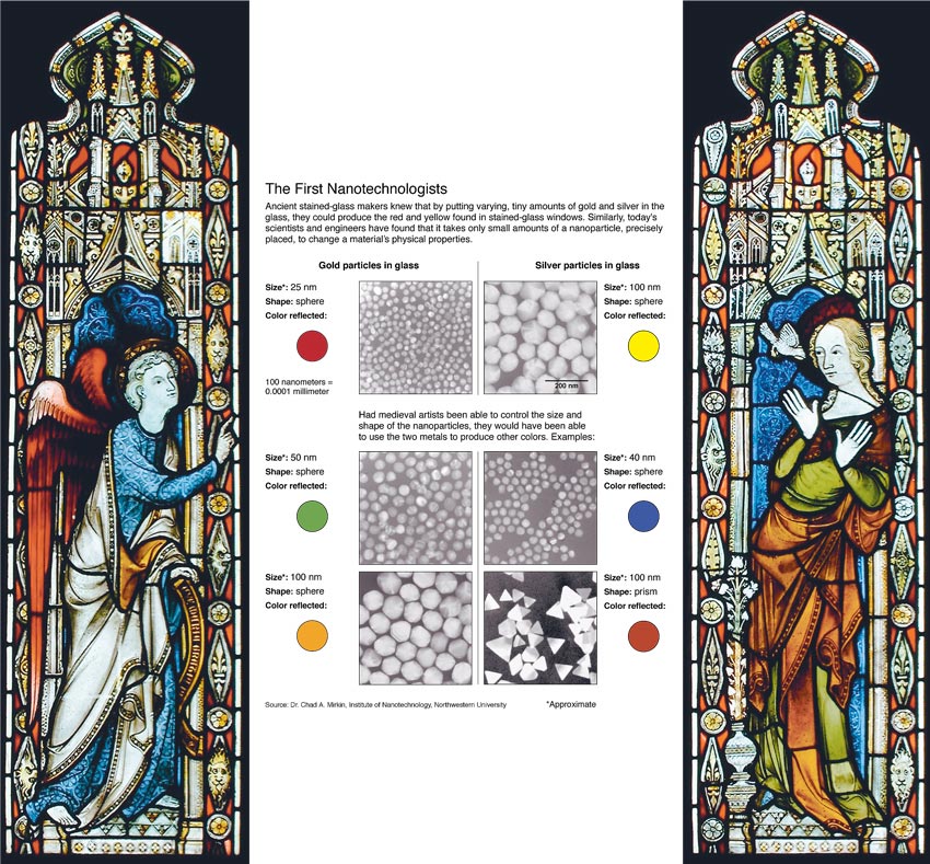

    Medieval Stained Glass and Nanoparticle Colors
