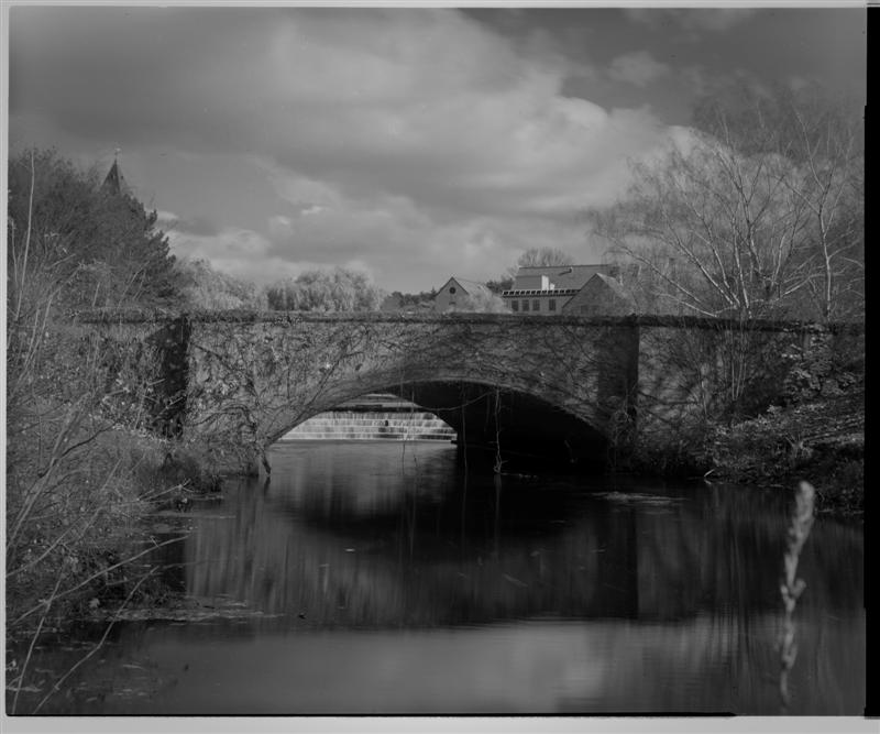

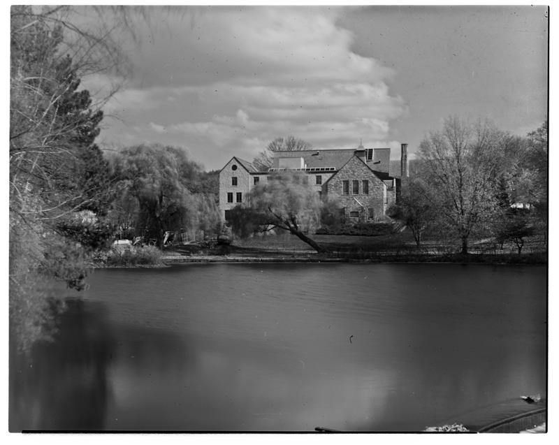

Not from the little green men! It took me a long time to find an old brass lens that wasn't tack sharp but didn't have swirly corners or a sharp center fading to softness at the edges. Rather, one that had the overall look of a pinhole but at f/11. The lens is unmarked, made for waterhouse stops which I don't have and probably wouldn't use. It is about 180mm and covers 4x5. I use it on a Speed Graphic. This is the first time I've tried to load a photo here so please cut me some slack. Oh, and this is just a work 8x10 scanned at 100dpi so if someone has a better way, I'd like to hear about it.

You could always make one (Anchor Optical, etc) :
and
I've since printed Becky's portrait on Ilford WT and it worked great! The scanner I used was never meant for negatives and so the scan is muddier than the final print was. Don't have the print to scan. Sorry.
outwest
outwest
Aug 18, 2005
565
Perhaps, but the examples you've given don't have the classic pictorial look I was after. They grow increasingly softer away from the center, which I would class as a portrait lens effect, and the OOF is not particularly smooth in my thinking. But, I'm sure the effort was fun and that is half of it!

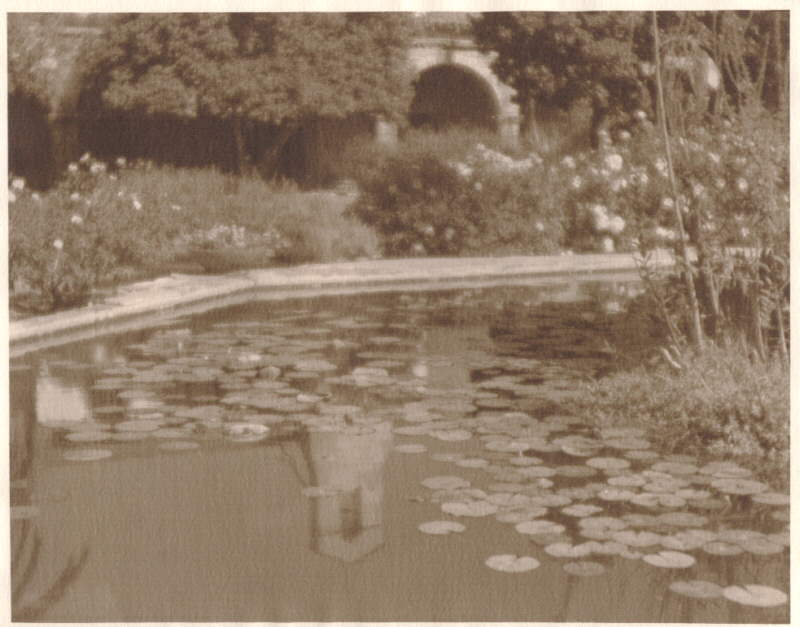

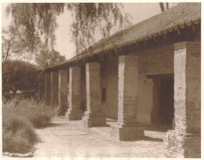

After seeing the book "Pictorialism in California", I finally had a chance to try the lens out on a classic pictorialist subject: San Juan Capistrano. These were on FP4+ with a green filter at 1/30 second in my Speed Graphic. The lens, the unmarked brassie 190mm f/11, was, of course, wide open.

Cool, those definitely have the classic pictorial look. I see some texture going on aside form the effects of the lens--are you using paper negs or some other techniques to get the look you want?
outwest
outwest
Aug 18, 2005
565
I suppose you are seeing the surface of the paper. Otherwise, straight prints from the 4x5 negs using a 135mm Componon-S on the FOMA warmtone paper toned in thiocarbamide.

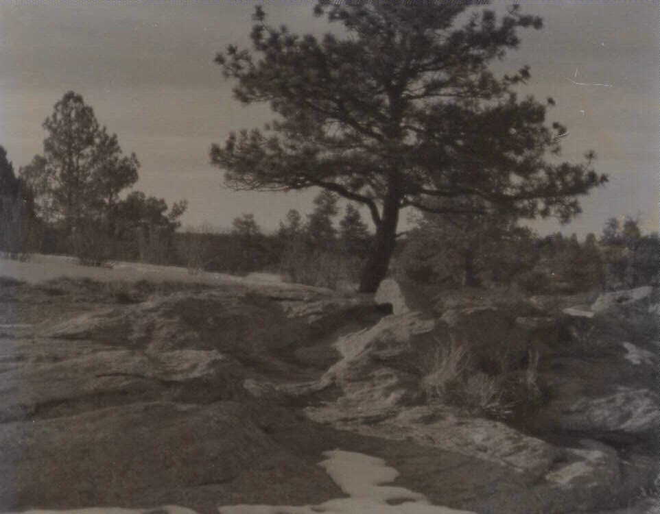

Outwest: You should look at other older lenses Like maybe a Planatograph F-8 4x5 approx 195 mm : see attached foto shot at F-32 on FP-4

Nice shots, Lauren. I have plenty of other older lenses - all sharp! It's hard to find a soft one.

outwest what you see is shot at f-32 , not ab le to get my F-8 shots at the moment since I am packing for a move
at F-8 its about as soft as it gets and still have some detail , all I can say is have fun with soft lenses :
