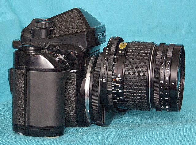

When I got my Pentax 6x7 Mk in 1979 I got the 75mm f4.5 'Shift' lens as I was getting some Architectural work for a company needing medium format transparencies of buildings for sale - I did a lot then suddenly the company went BROKE and all the work dried up ! I now use the shift lens occasionally for 'Club' photos -- here are a couple ---

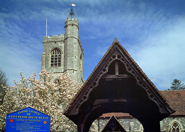

Pentax 6x7 03 by pentaxpete, on Flickr
A local Church -- here I used the shift lens to get rid of several parked cars underneath the blue board so I had to cut off the base of photo.
AGFA ULTRA 50 film processed in C41 myself Pentax 6x7 Mk II

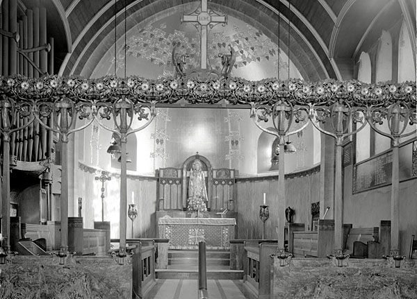

Ultra 05 by pentaxpete, on Flickr
Here is an interior of a well-known Church on Pentax 6x78 Mk I and Ilford XP1 film. Time exposure + a few flashes from Mecablitz 45CT1
All Saints Warley by pentaxpete, on Flickr

The principle of using shift is not fulfilled without a retrograde shift or tilt of the camera back. This is illustrated in the church shot; in terms of perspective the appearance is jarring. What should be happening is the camera (film plane) shifted to compensate for the shift at the lens — something the Hasselblad Flexbody does well, but which view cameras do superbly (one of very few instances where I would recommend a view camera explicitly over other formats). It's fine to move the lens up to take in more of the taller parts, but unless there is a corresponding correction at the film plain, the effect is compromised, hence the reason view cameras were once the go-to device for architecture.
I have used a PC lens on the smaller 35mm format since 1994, chiefly in landscape for correction of viewing angles and levels (tilt + shift) and not at all for "correction" of verticals because of the limitations of not having an adjunct correction at the film plane.

Hi Pete, I think the key is to ensure that vertical lines remain vertical in your photograph. That is the advantage of a PC lens, it provides you the opportunity to frame your composition without tilting the camera back. If the the vertical lines are straight, you did it right. I'm not familiar with any need to adjust the camera back to compensate for this. I aim to get the camera back (film plane) level at all times, when vertical lines are an issue. Just my 2 cents...

That is great, thanks for sharing. Sure beats lugging around a monorail 4x5. Tilt lenses are nice also, do you have one?
Of course to have verticals non-converging the camera back always has to be adjusted; that is the key point, the film has to be parallel to the structure. Of course everyone knows the cool thing that when they built the structure they made it plumb, so by making the film plane plumb you have made it parallel to the structure without lasers or complex triangulation :smile:. Obviously in a camera like this the tripod head performs the function of film plane positioning, allowing an infinite number of choices in horizontal and vertical positioning.
