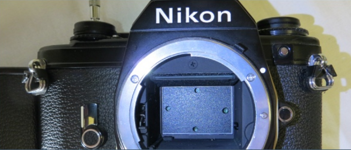

    I am having problem testing the shutter speed of cameras in automatic mode like the EM. You would need a light source that simulate the correct brightness to get the camera to set at the correct shutter speed and the tester must work with that level of light.

    This is not a matter of sensor location (as you referered to a respective photo), but of light source. Actually such is a different kind of tester.
    A shutter speed tester in the proper meaning only tests the shutter, not a exposure automatic.
