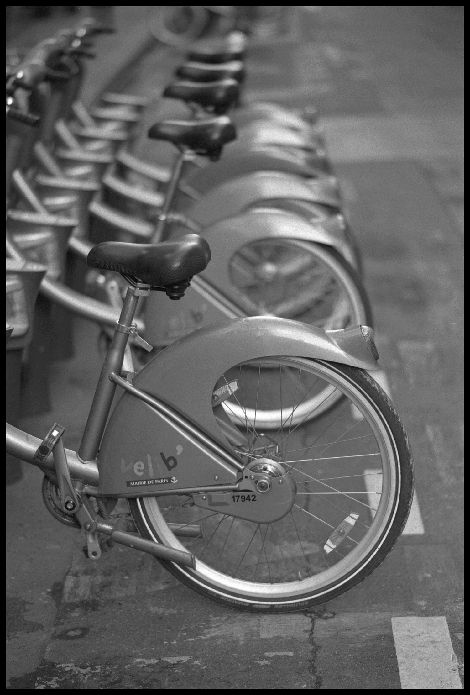

If by "replete the silver back to the film" you mean redeposit the silver in solution back on the film, I wouldn't necessarily consider that a bad thing. I'm attaching a photo made on Arista 400, usually considered a fairly grainy film, developed in D-76 with added Aluminum Chloride, which has the effect of plating the silver back on the image. I hope you'll agree that the grain is good and the tonality is acceptable. (Photo made with Minolta SRT-101 with 85mm f/1.8 Rokkor, I believe.)
