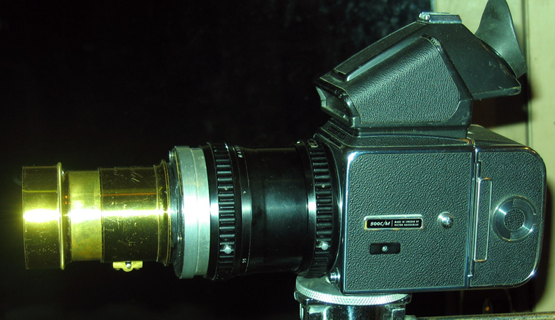

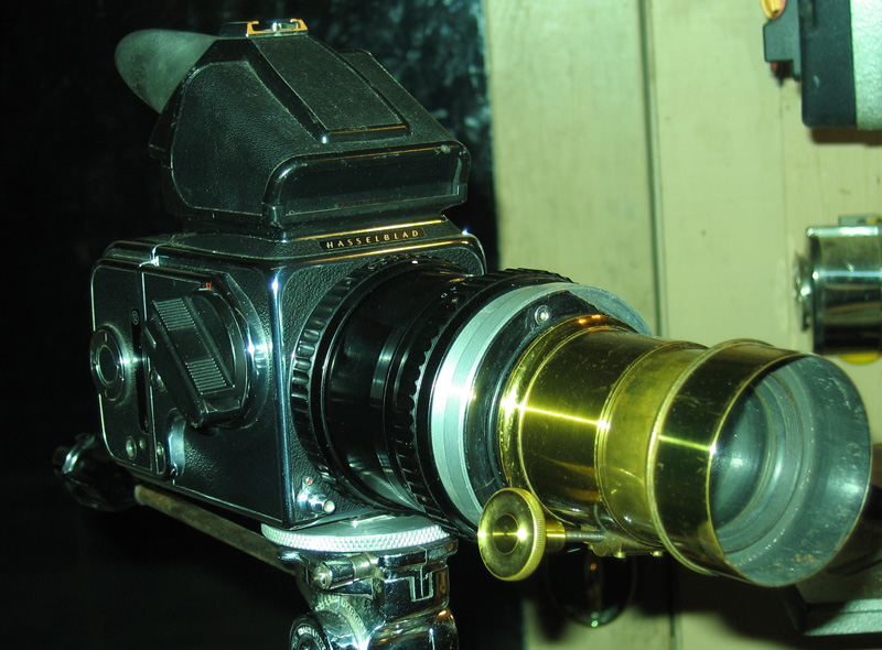

I don't have any gallery images made with it, but here are pix of the rig.
I had a Hasselblad Lens Mount adaptor which I drilled and tapped for the Petzval's flange. Then it needed an extension tube to get it out to reasonable focusing range. Fine focus happens with the focusing rack on the lens.
