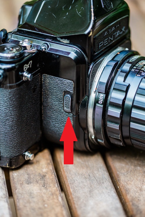

I'm possibly looking to purchase a super-clean Pentax 6x7 from a reputable dealer, but was curious, would anyone know when exactly (referring to serial number) that this camera started to be equipped with the mirror lock-up (MLU) function?
Knowing a relative serial number would be quite interesting, but if one is unknown, what does this function exactly look like on the outside?

Hi,
Identification of MLU on the body is simple:
DREW WILEY
Jul 14, 2011
13,930
8x10 Format
... as long as it's a picture of the actual camera for sale, rather than a generic image.
