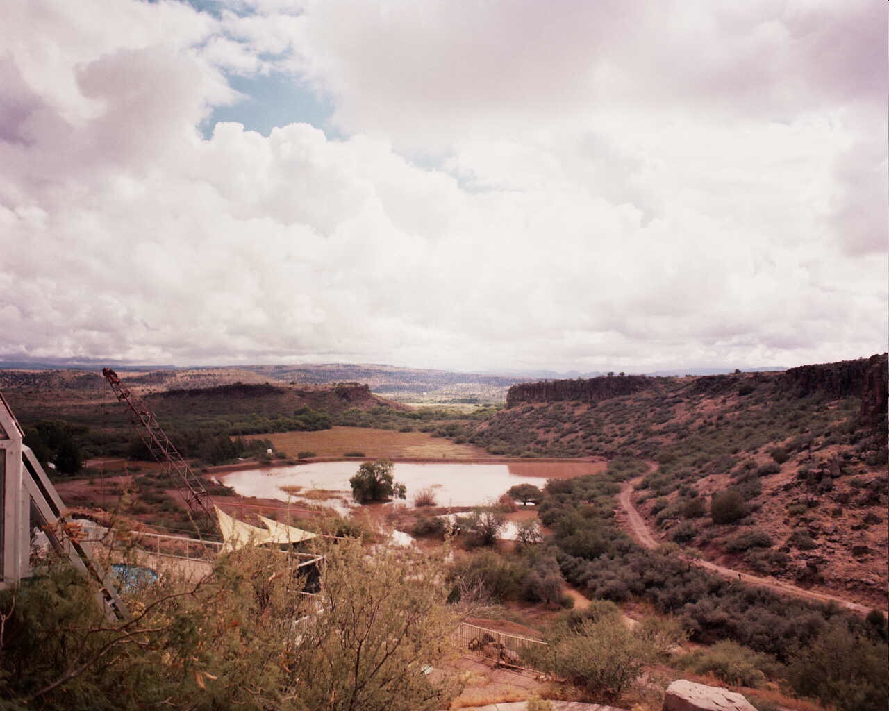

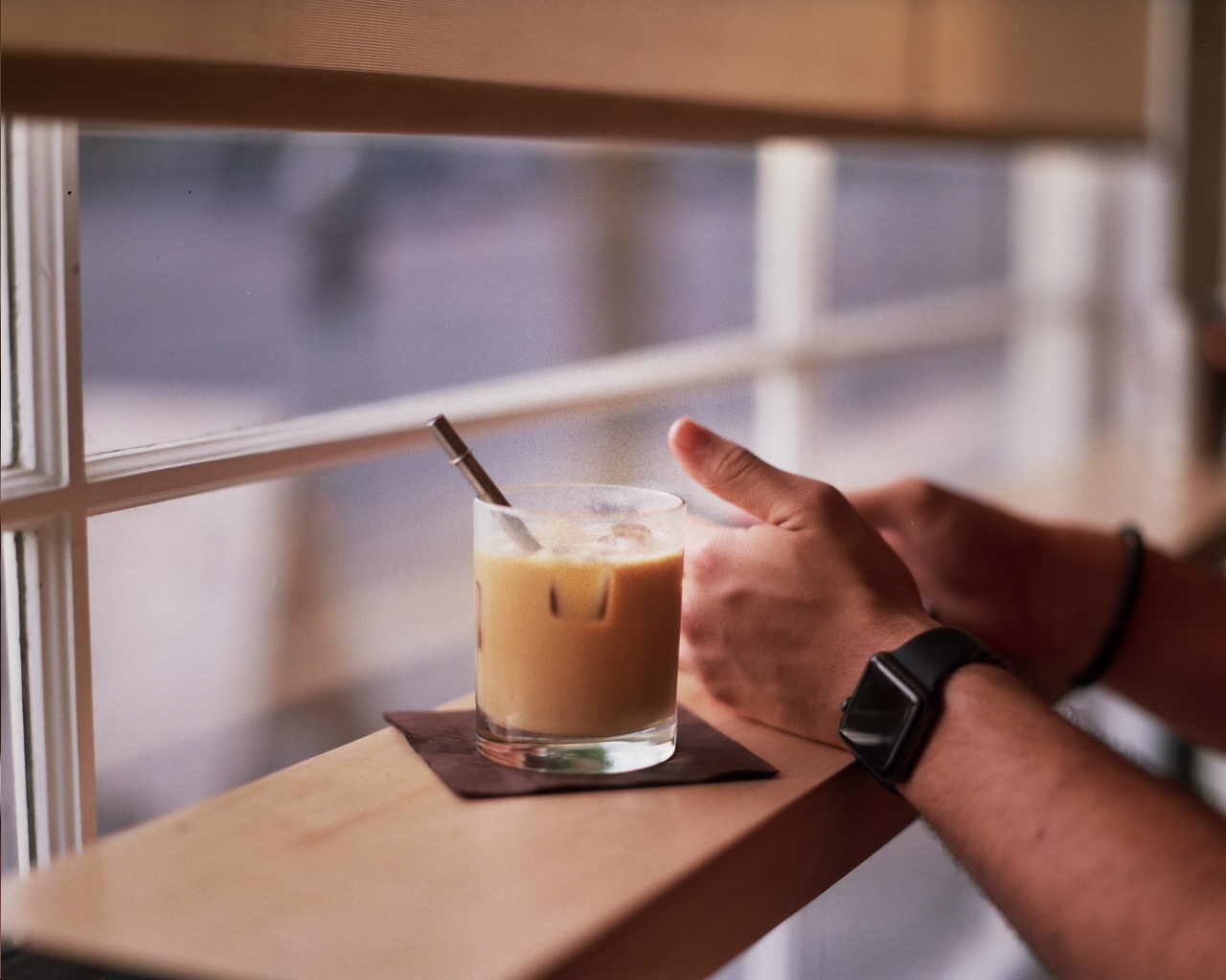

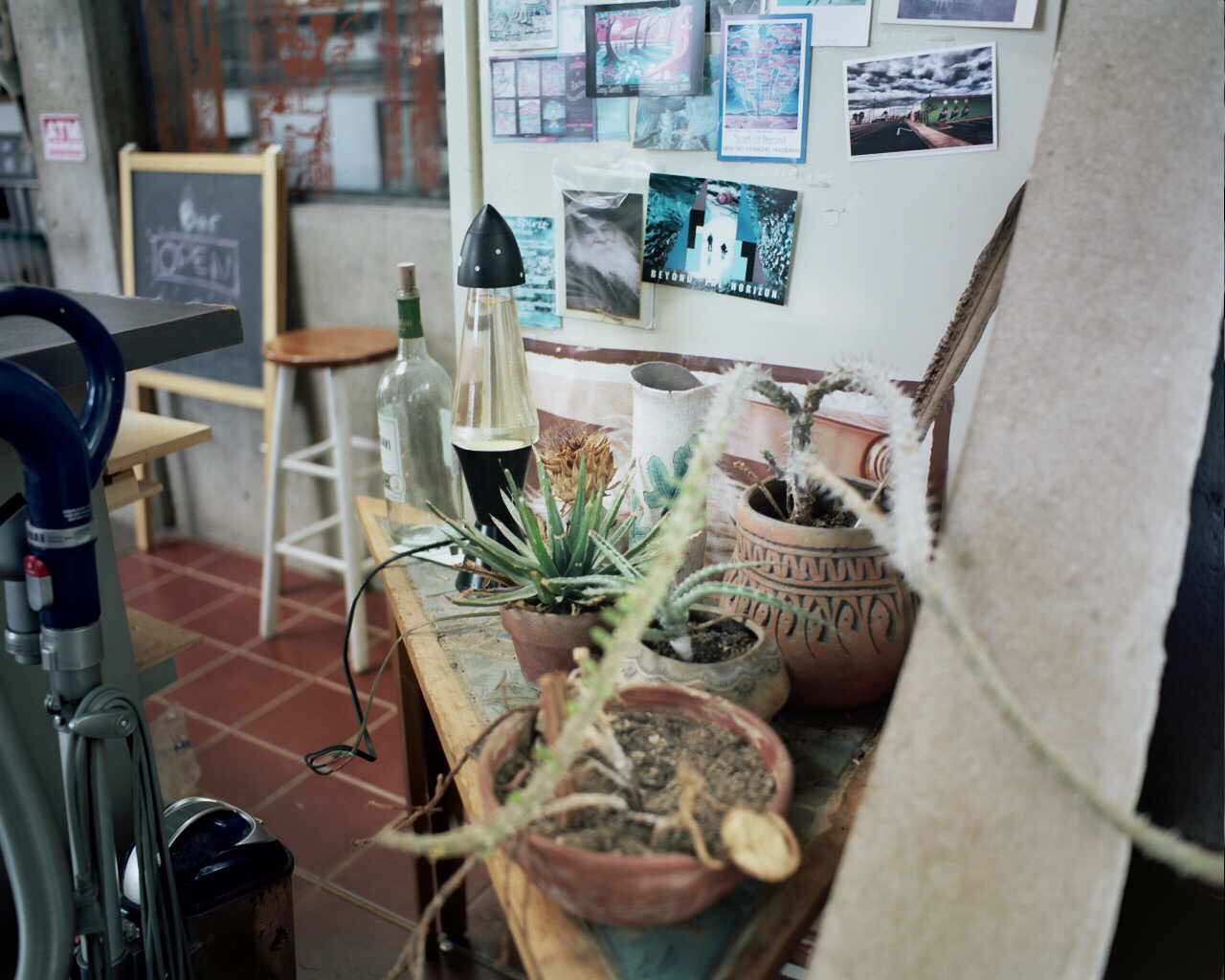

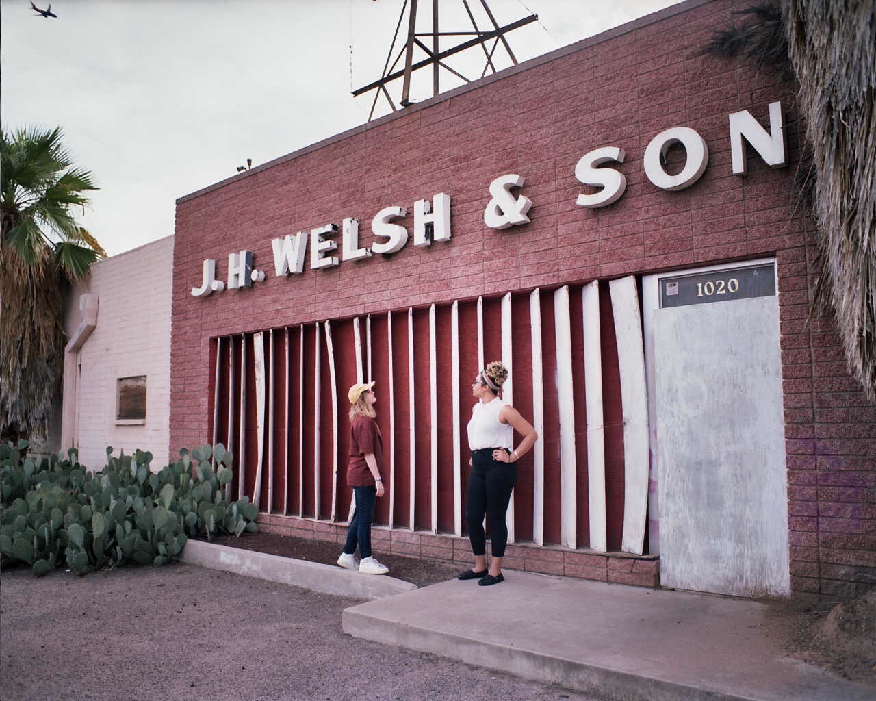

    Hi all, would really appreciate some feedback here,
    About a month ago I purchased a Pentax 67 MLU, and then a 105mm f2.4 and then a 55mm f3.5, to hopefully replace my F3. Originally I was hoping that switching from 35mm to 120 (and a 6x7 at that), would give me what i'm looking for exposure-wise, and in many ways it has. I really enjoy the expansiveness of the aspect ratio, and the sharpness I am able to achieve is unbelievable.
    I'm noticing however, that with my style of photography- solely utilizing available light and often indoors, all while trying to quickly capture fleeting moments- this camera (or medium format in general) may not be the best fit. Along with that, even when shooting well-lit indoors (and even outdoors at times..?) with my Pentax loaded with Portra 800, i'm guaranteed to be subject to color shifts due to underexposure (i'm assuming), while my F3 would easily nail it. I have found that I am able to hand hold even down to 1/30th quite easily, but that seems to be of no avail.
    So that all brings me to seek some advice:
    Is there a way to compensate for the color shifts due low light exposures short of post-production, external lighting sources, or even using a tripod for longer shutter speeds? (asking a lot, I know). Could pushing in-development be a way to get around this? Worse yet, is this just something you can't even work around with such a large camera while hand-holding?
    AND IF THAT'S THE CASE: any ideas for any alternatives? Lighter-weight medium formats? Smaller ratios?
    Again, thank for reading and any help.
    (I've attached some of the worst offenders below
    Indoors were shot on Portra 800, outdoors were shot on Portra 400)

    First of all, don't underexpose the film. When in doubt, test in analogous lighting prior to any serious project. Second, you probably need corrective filters for artificial lighting. Today's miserable low-E light sources don't make life any easier in that respect. You're NOT likely to be able to post-correct certain things, so don't count on that. It's far easier in the long run to do your homework in advance and do any necessary color corrections during the shoot itself. This is nothing new - it's how it's
    been done for decades. Often photographers had to bring in their own lights balanced to the film. With the P67 there's no compensating dial; you simply readjust your ASA if you want to use TTL metering. I prefer a handheld light meter; but what matters most is experience with your chosen meter. The P67 system isn't realistic handheld unless fast shutter speed are used. There's a simple alternative : it's called a good tripod. And I recommend mirror lock-up for any exposure longer than 1/60th. Don't get frustrated. There's a learning curve when you step up to a larger format. Spending some time to figure it all out will be well worth it. If you simply have to have something more automated, the Pentax 645 system would be appropriate,
    and with an adapter, you can still use your P67 lenses. But there are real rewards learning how to manually control the
    pertinent variables.

    With smaller apertures one must use slower shutter speeds to get the equivalent exposure obtained with a larger aperture opening. 1/125 @ f2 will be 1/60 @ f3.5 or 1/30 @ f5.6.
    Many indoor shots require 1 to 1 1/2 stops more exposure than indicated due to light falloff from the source.
    Get an 18% gray card and read the exposure off it and put it in the scene for test purposes.
