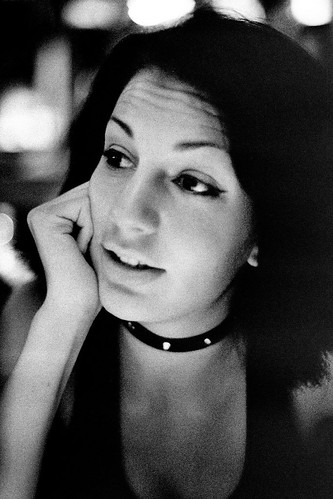

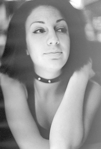

One hour, 1+100, agitation 5 secs every 12 minutes... my guess is thermal convection along the surface of the film, since the streaks align either with the sprocket holes (esp in this one) or on occasion there will be a dark stripe trailing-away from a highlight — indicating that the developer was exhasted there and wasn't fogging the base as much as it was in other areas.
Maybe just pulling back to less than an hour will do the trick and avoid this fogging....
Tri-X rated ISO 2400 btw.
Print with high-enough contrast, though....

Yes, I'm buying the "bromide streak" theory and will shorten-up the agitation intervals in the first part of the development.
(Yes, they're both Tri-X, they're two or three frames apart on the same roll!)

I'd agree -- I've been using the same method (even less agitation) on Acros without any noticeable bad behavior.
And even from this same batch of three rolls, some strips seem streak-free:
