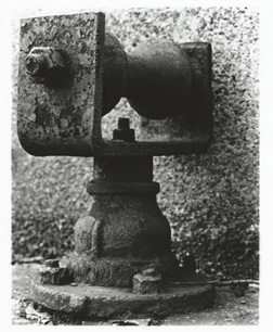

Scan samples
Here are the two samples. The Foma is FomaTone MG classic, Chamois 542. The Kentmere is Fineprint VC.

comparing the two...
...I can't decide which I like the most.
The warm tones of the Foma give the print an atmospheric antique look-but the cooler tones of the other print look good too.
Personally,I'd be more inclined to use the Foma more for artistic portraits,and possibly shots of old buildings-and the other paper for general use.
