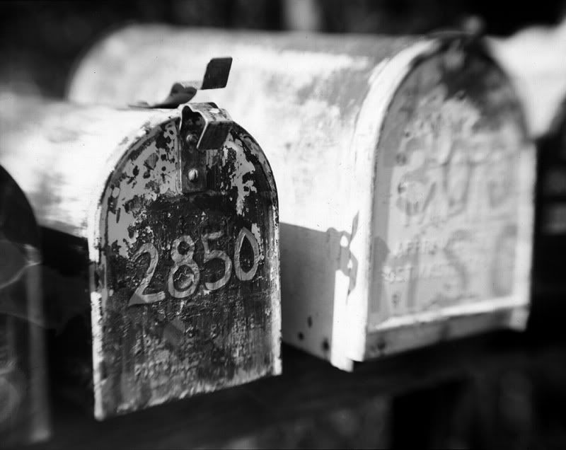

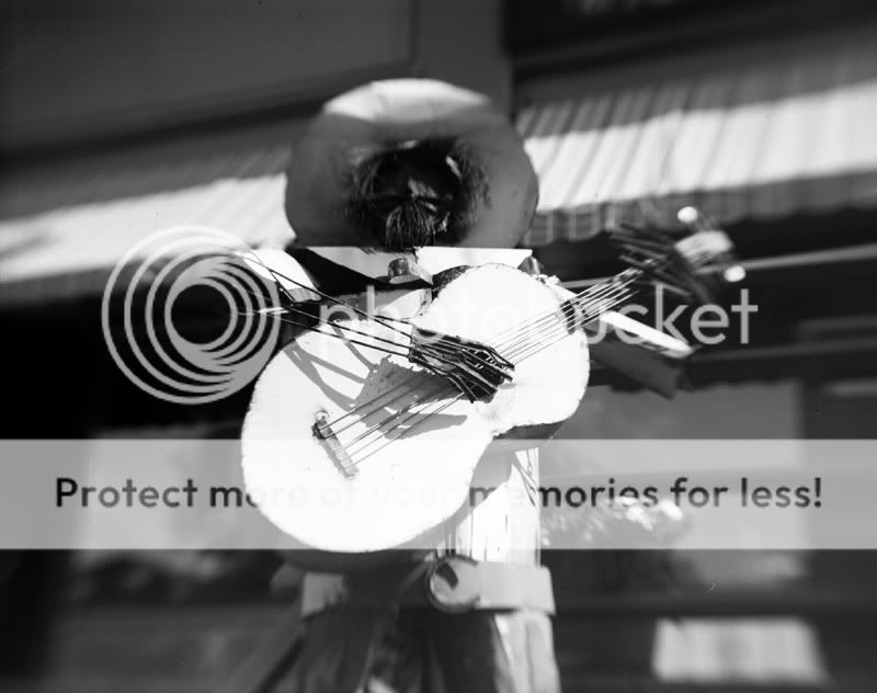

More playing around with adapted optics mounted on my 4"x5" Speed Graphic, using the trusty 150mm binocular lens, stopped down to F/8. Exposures timed via the curtain shutter.
Preflashed grade 2 paper negatives.
Madrid, NM.
~Joe

This looks great! I would love to know which types of paper/dev you have found to work with paper negs?

Thanks for your comments. I use Freestyle's Arista brand RC grade 2 paper as an in-camera negative; have been doing so for a few years now. I've commented previously on APUG about using this paper as a negative medium, by preflashing the paper to an otherwise faint gray tone, and the use of slightly dilute developers. I like either Agfa Neutol WA, or Ilford Universal Paper developer, diluted around 1+15. I rate the paper's Exposure Index around 12, assuming the developer is fresh, and at 68f.
Other folks seem to get good result in controlling excess contrast with paper negatives by using a yellow filter over the lens and using multigrade paper; I never went the way of the yellow filter because in pinhole photography you can detect evidence of the presence of the filter over the aperture if there are flaws in the filter. I also like the idea of a predetermined contrast grade for a negative media, something you can't get with sheet film itself. And I don't like the idea of the scene's coloration affecting the contrast of the negative, which is what happens with using multigrade paper. But, that's just me.
So, I stick with using the grade 2 Arista as my film, and use multigrade fiber paper for contact prints. Also, I've yet to get involved with contact printing paper negatives onto Lodima silver chloride paper; that will be something for the future.
~Joe
