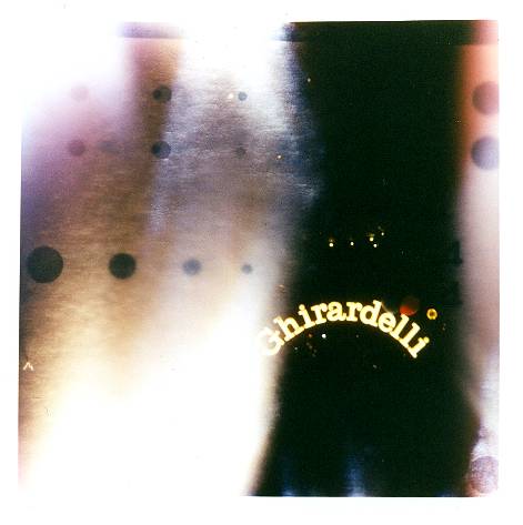

I've had it happen to me! Both rolls of Fuji I shot in San Francisco back in August didn't roll tight, one totally didn't even come out and the other had tons of paper imprinted all over it. I figured it happened because of the improper rolling allowing light to expose through somehow.
Examples:
